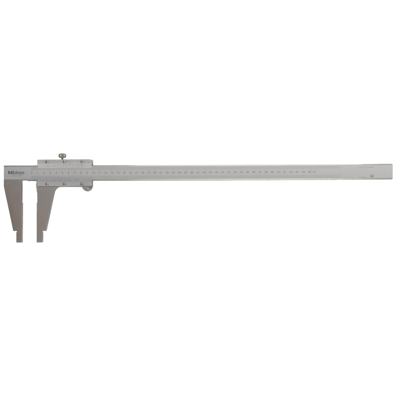

The Mitutoyo Vernier caliper with nib jaws provides highly accurate inner and outer dimension measurements.
Vernier Scale Caliper with Nib Style Jaws
The Mitutoyo Vernier scale caliper utilizes nib jaws with round measuring faces to perform precision inner and outer dimension measurements when high accuracy is necessary. The Vernier caliper’s 14-degree face angle offers easier reading and helps prevent parallax error in the measurement. The scales are raised to slide easily and protect the graduation markings. The Vernier caliper with thumb clamp is constructed of hardened stainless steel that is corrosion resistant and has a satin chrome finish which reduces glare.
  • The caliper is constructed of corrosion-resistant, hardened stainless steel
  • Lock screw holds the sliding jaw position to obtain accurate measurements
  • The caliper meets Federal Accuracy Specifications GGG-C-111B
  • Most models supplied with a vinyl holster in a fitted carton
  • The 300mm / 12″ and 450mm / 18″ models supplied in a fitted carton only
  • Models over 600mm / 24″ supplied in a wooden case
SERIES Vernier Scale Caliper with Nib Style Jaws Technical Data
Technology: Mechanical
Units: Metric
Minimum dimension in ID measurement: 20mm
Order No.: Product Image: Units: Range: Accuracy: Graduation: Mass:
160-130 Metric 0-450mm ±0.1mm 0.02mm 1100g
160-131 Metric 0-600mm ±0.1mm 0.02mm 1300g
160-132 Metric 0-1000mm ±0.15mm 0.02mm 3350g
160-133 - Metric 0-1500mm ±0.22mm 0.05mm 4850g
160-134 - Metric 0-2000mm ±0.28mm 0.05mm 10000g
