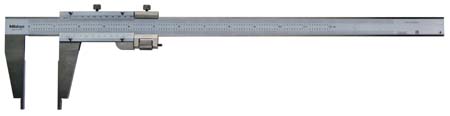

Vernier Scale Caliper with Nib Style Jaws and Fine Adjustment
The Mitutoyo Vernier caliper with nib jaws and fine adjustment carriage precisely controls the movement of the Vernier scale for highly accurate inner and outer dimension measurements.
View Dimensions
The Mitutoyo Vernier scale caliper utilizes nib jaws with round measuring faces and a fine adjustment carriage to perform precision inner and outer dimension measurements. The adjustment carriage feeds the slider finely to give added control and deliver the highest accuracy possible. The Vernier caliper’s 14-degree face angle offers easier reading and helps prevent parallax error in the measurement. The scales are raised to slide easily and protect the graduation markings. The Vernier caliper with thumb clamp is constructed of hardened stainless steel that is corrosion resistant and has a satin chrome finish which reduces glare.
  • Available in Metric and Metric/Inch models
  • Inch and Metric/Inch models have dual reading scales on Vernier
  • The caliper is constructed of corrosion-resistant, hardened stainless steel
  • Lock screw holds the sliding jaw position to obtain accurate measurement
  • The caliper meets Federal Accuracy Specifications GGG-C-111B
  • Most models supplied with a vinyl holster in a fitted carton
  • The 300mm / 12″ and 450mm / 18″ models supplied in a fitted carton only
  • Models over 600mm / 24″ supplied in a wooden case

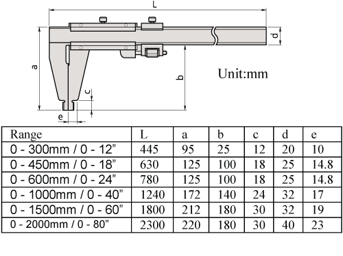

SERIES 160 Technical Data
Technology: Mechanical
Order No.: Product Image: Units: Range: Minimum dimension in ID measurement: Accuracy: Mass: Graduation Lower Scale: Graduation Upper Scale:
160-101 Metric 0-600mm 20.1mm ±0.05mm 2600g 0.02mm 0.02mm
160-102 - Inch 0-24" 0.504" ±0.0020" 1400g 0.001" 0.001"
160-103 - Metric, Inch 0-24" 0.504" ±0.0020" 1400g 0.001" 0.02mm
160-104 - Metric 0-1000mm 20.1mm ±0.07mm 3500g 0.02mm 0.02mm
160-105 Inch 0-40" 1.004" ±0.0030" 3500g 0.001" 0.001"
160-106 - Metric, Inch 0-40" 1.004" ±0.0030" 3500g 0.001" 0.02mm
160-112 - Metric, Inch 0-60" 1.004" ±0.0040" 4850g 0.001" 0.02mm
160-113 - Metric 0-2000mm 20.1mm ±0.12mm 10200g 0.02mm 0.02mm
160-114 - Inch 0-80" 1.004" ±0.0050" 10200g 0.001" 0.001"
160-115 - Metric, Inch 0-80" 1.004" ±0.0050" 10200g 0.001" 0.02mm
160-116 Inch 0-18" 0.504" ±0.0020" 1200g 0.001" 0.001"
160-119 - Metric, Inch 0-18" 0.504" ±0.0020" 1200g 0.001" 0.02mm
160-124 Inch 0-12" 0.304" ±0.0015" 450g 0.001" 0.001"
160-125 Metric, Inch 0-12" 0.304" ±0.0015" 450g 0.001" 0.02mm
160-127 - Metric 0-300mm 10.1mm ±0.04mm 450g 0.02mm 0.02mm
160-128 - Metric 0-450mm 20.1mm ±0.05mm 1200g 0.02mm 0.02mm
160-150 - Metric, Inch 0-300mm 10.1mm ±0.04mm 450g 0.02mm 0.001"
160-151 - Metric, Inch 0-450mm 20.1mm ±0.05mm 1200g 0.02mm 0.001"
160-153 - Metric, Inch 0-600mm 20.1mm ±0.05mm 1400g 0.02mm 0.001"
160-155 - Metric, Inch 0-1000mm 20.1mm ±0.07mm 3500g 0.02mm 0.001"
160-157 - Metric, Inch 0-1500mm 20.1mm ±0.09mm 4850g 0.02mm 0.001"
160-159 - Metric, Inch 0-2000mm 20.1mm ±0.12mm 10200g 0.02mm 0.001"
