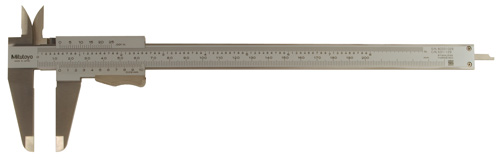

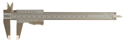

Vernier Scale Caliper with Thumb Clamp
The Mitutoyo Vernier caliper features a thumb clamp that controls the sliding movement of the Vernier scale to precisely hold measurements for more accurate, easy reading and recording.
View Dimensions
The Mitutoyo Vernier scale caliper features a spring-loaded thumb clamp that moves the slider only when depressed, giving the operator better control to hold measurements for improved accuracy. The Vernier caliper’s 14-degree face angle offers easier reading and helps prevent parallax error in the measurement. The scales are raised to slide easily and protect the graduation markings. The Vernier caliper with thumb clamp is constructed of hardened stainless steel that is corrosion resistant and has a satin chrome finish to reduce glare.
  • Capable of measuring outside, inside, depth and step dimensions
  • Available in Metric and Metric/Inch models
  • Inch and Metric/Inch models have dual reading scales on Vernier
  • Carbide-tipped jaws are available
  • The caliper is constructed of corrosion-resistant stainless steel
  • Lock screw holds the sliding jaw position to obtain accurate measurements
  • Supplied with a vinyl holster in a fitted carton

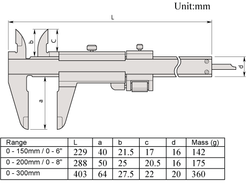

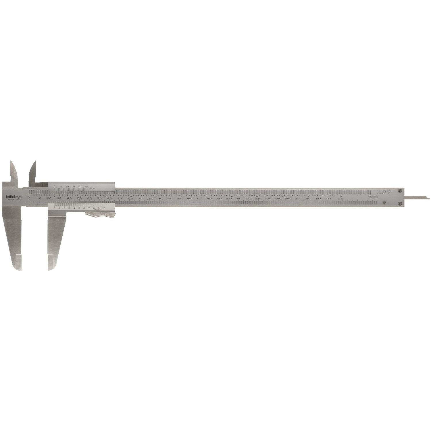

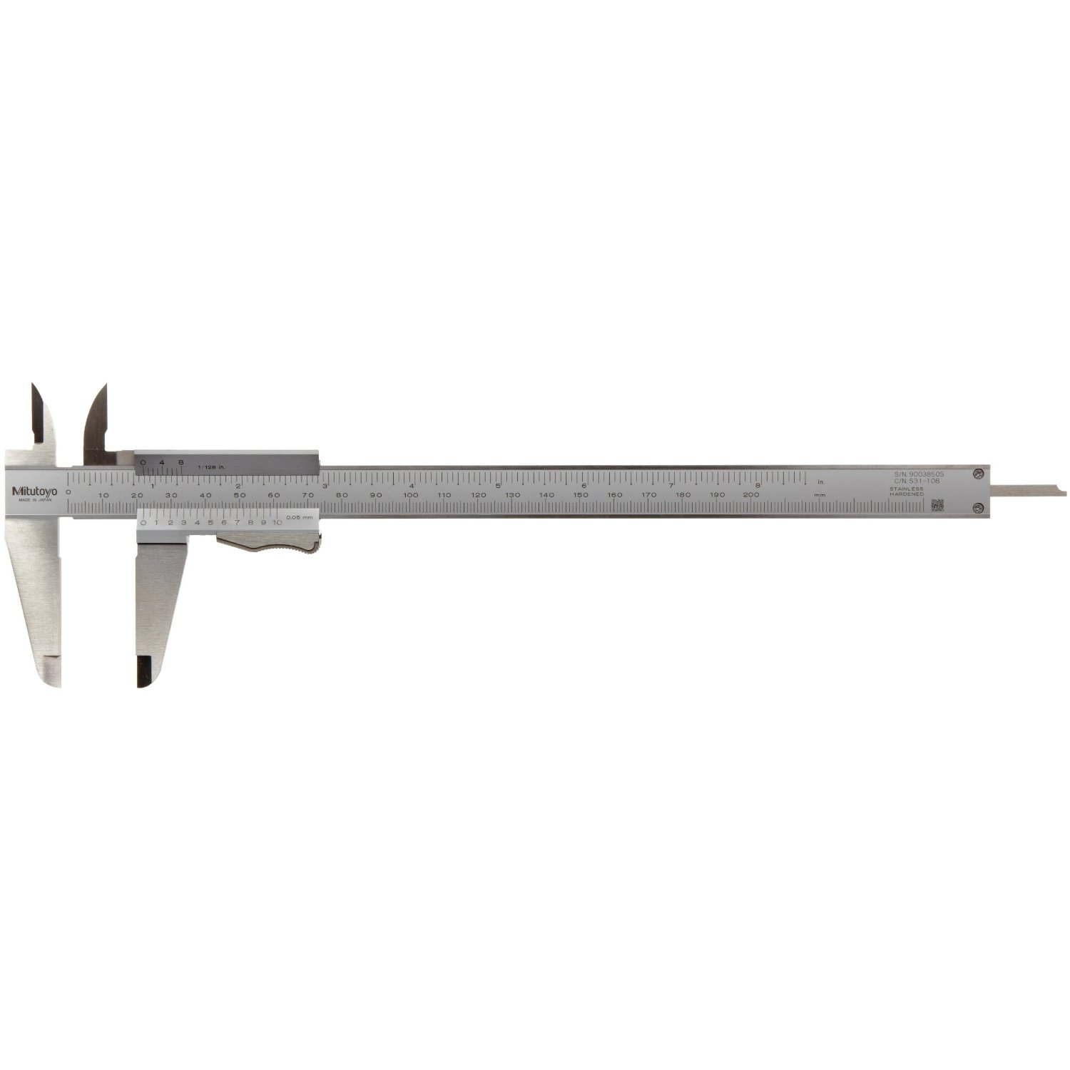

SERIES 531 Technical Data
Technology: Mechanical
Order No.: Product Image: Units: Range: Accuracy: Mass: Graduation: Graduation Lower Scale: Graduation Upper Scale: Remarks:

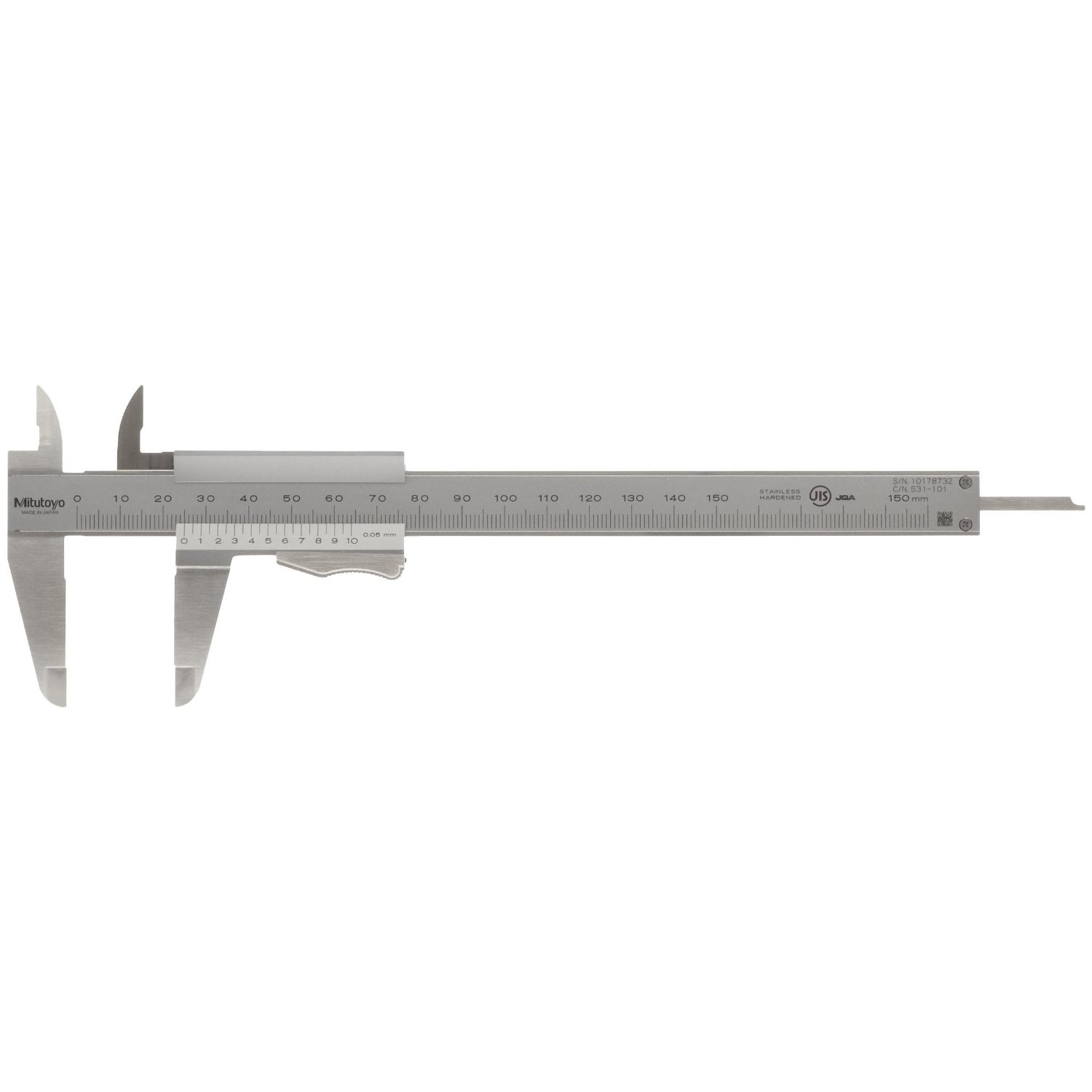

531-101 Metric 0-150mm ±0.05mm 142g 0.05mm - - -

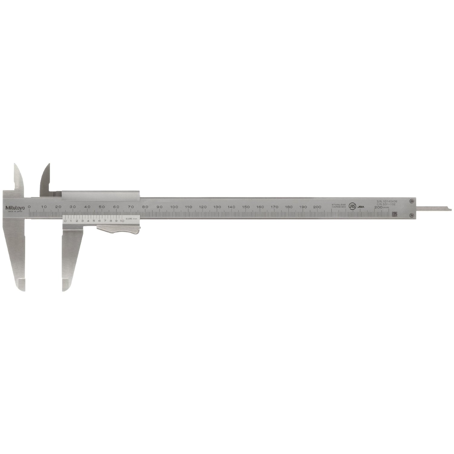

531-102 Metric 0-200mm ±0.05mm 175g 0.05mm - - -

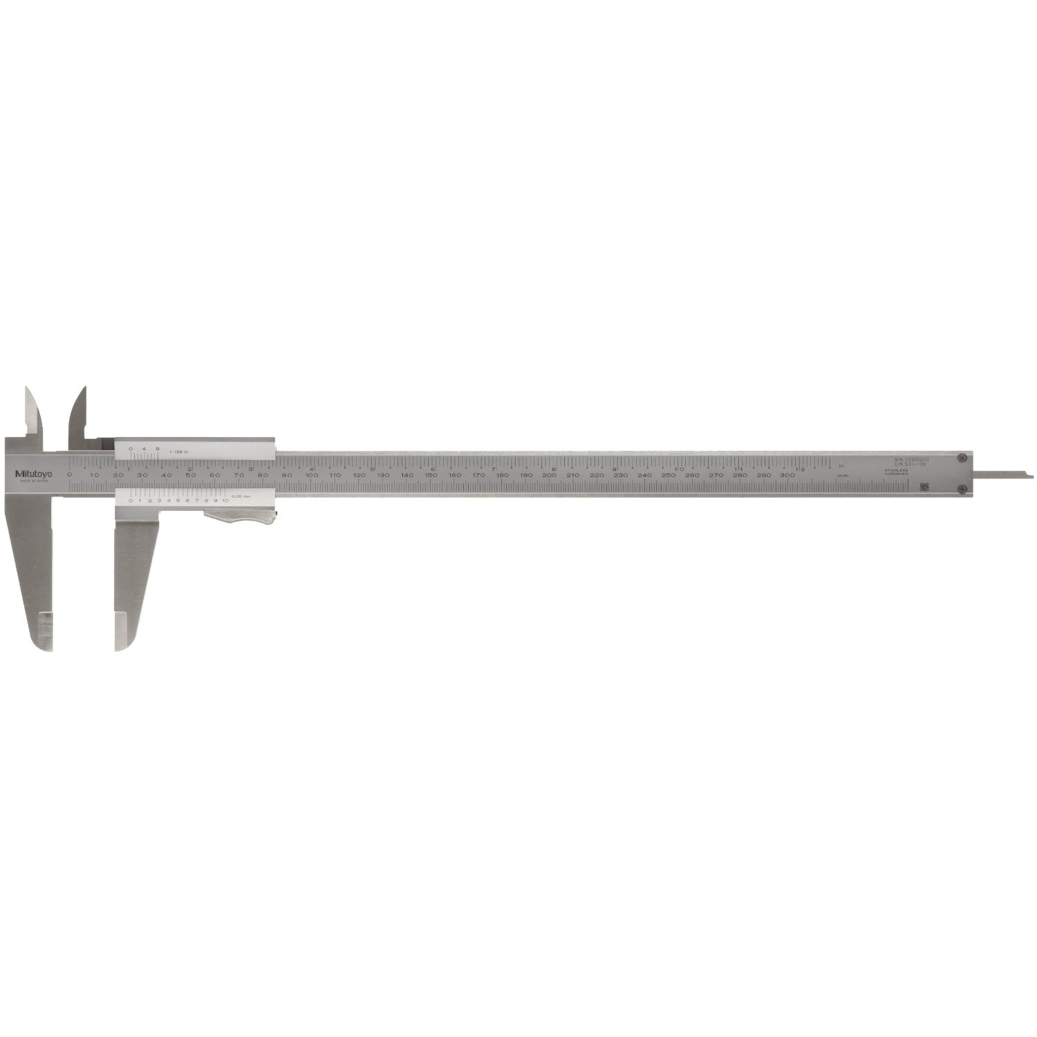

531-103 Metric 0-300mm ±0.08mm 360g 0.05mm - - -
531-108 Metric, Inch 0-200mm / 0-8" ±0.05mm 175g - 0.05mm 1/128" -

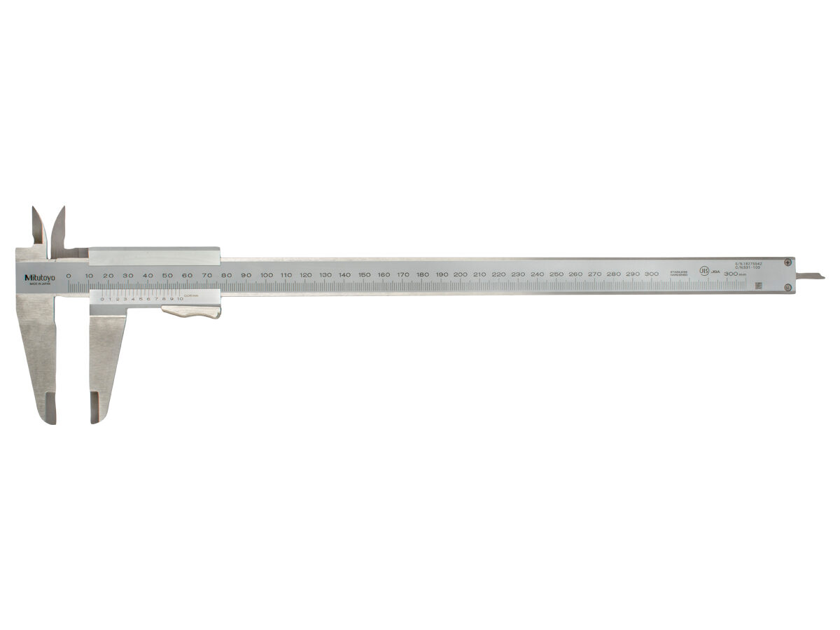

531-109 Metric, Inch 0-300mm / 0-12" ±0.08mm 360g 0.05mm 0.05mm 1/128" -
531-112 Metric, Inch 0-300mm / 0-12" ±0.04mm 360g - 0.02mm .001" High-accuracy model
531-122 Metric, Inch 0-150mm / 0-6" ±0.05mm 142g - 0.05mm 1/128" w/ inch/mm conversion label
531-128 Metric, Inch 0-150mm / 0-6" ±0.03mm 142g - 0.02mm .001" High-accuracy model
531-129 Metric, Inch 0-200mm / 0-8" ±0.03mm 175g - 0.02mm .001" High-accuracy model
