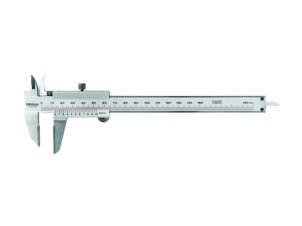

The Mitutoyo Vernier scribing caliper is equipped with sharp, carbide-tipped jaws that enable fine scribing on workpieces as well as take accurate measurements.
Vernier Scribing Caliper
The Mitutoyo Scribing Caliper features two sets of specially designed jaws for inside and outside dimensions. The jaws are tipped with carbide and are sharper than standard caliper jaws to enable fine scribing on workpieces when needed. The scribing caliper is constructed of hardened stainless steel with a satin chrome finish for protection and easy reading.
- Available in Metric models
- Raised sliding surfaces prevent defacement and wear of scale graduations
- Jaws are tipped with carbide for scribing and offer better accuracy and longer performance
- Constructed of corrosion-resistant, hardened stainless steel
- Lock screw holds the sliding jaw position for accurate measurement
