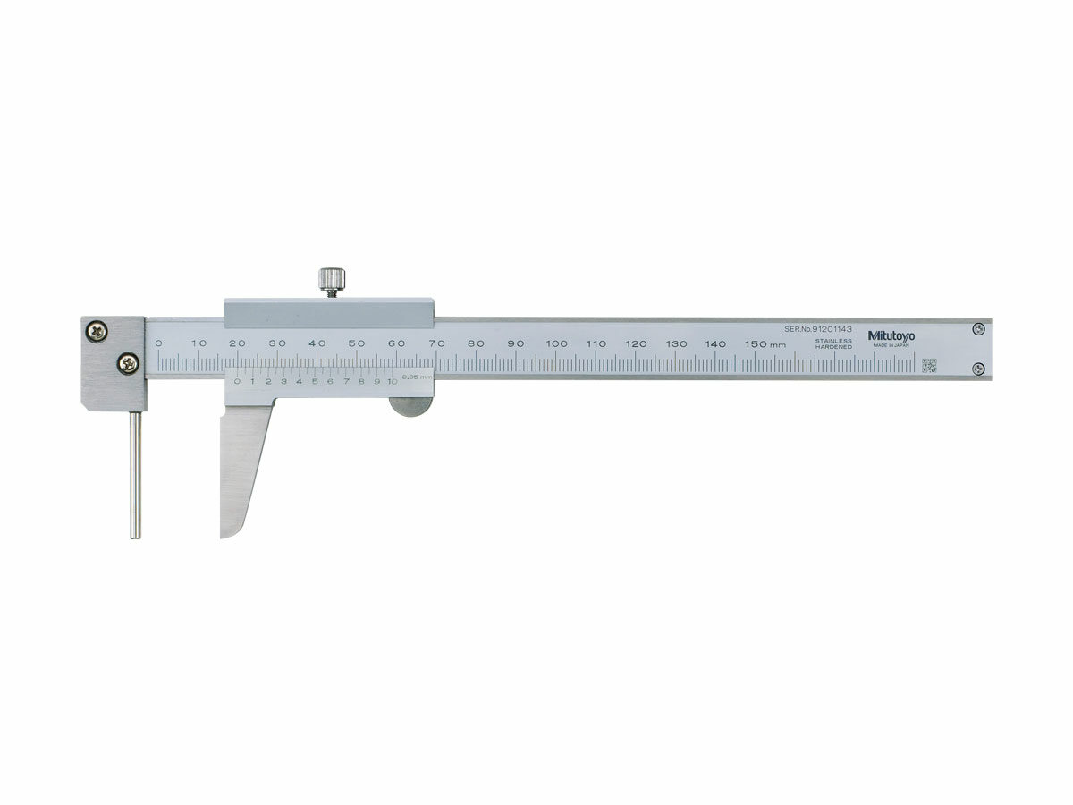

Vernier Tube Thickness Caliper
The Mitutoyo Vernier Tube Thickness caliper features a round bar and flat jaw to measure the wall thickness of tubes, pipes and other round parts with high accuracy.
The Mitutoyo Vernier Tube Thickness caliper includes a main scale which consists of a round bar and blade-type jaw constructed of hardened steel to take highly accurate wall thickness measurements of round pieces. The round bar allows the jaw to match the rounded contour of tubes and pipes for precise measurements.
  • Available in Metric models
  • Range is 0-150mm with accuracy rated at +/- 0.05mm
  • Jaws are tipped with carbide for better accuracy and durability
  • Constructed of corrosion-resistant, hardened stainless steel
  • Lock screw holds the sliding jaw position for accurate measurement
Order No.: Product Image: Units: Technology: Range: Graduation: Accuracy: Mass:
536-161 Metric Mechanical 0-150mm 0.05mm ±0.05mm 150g
