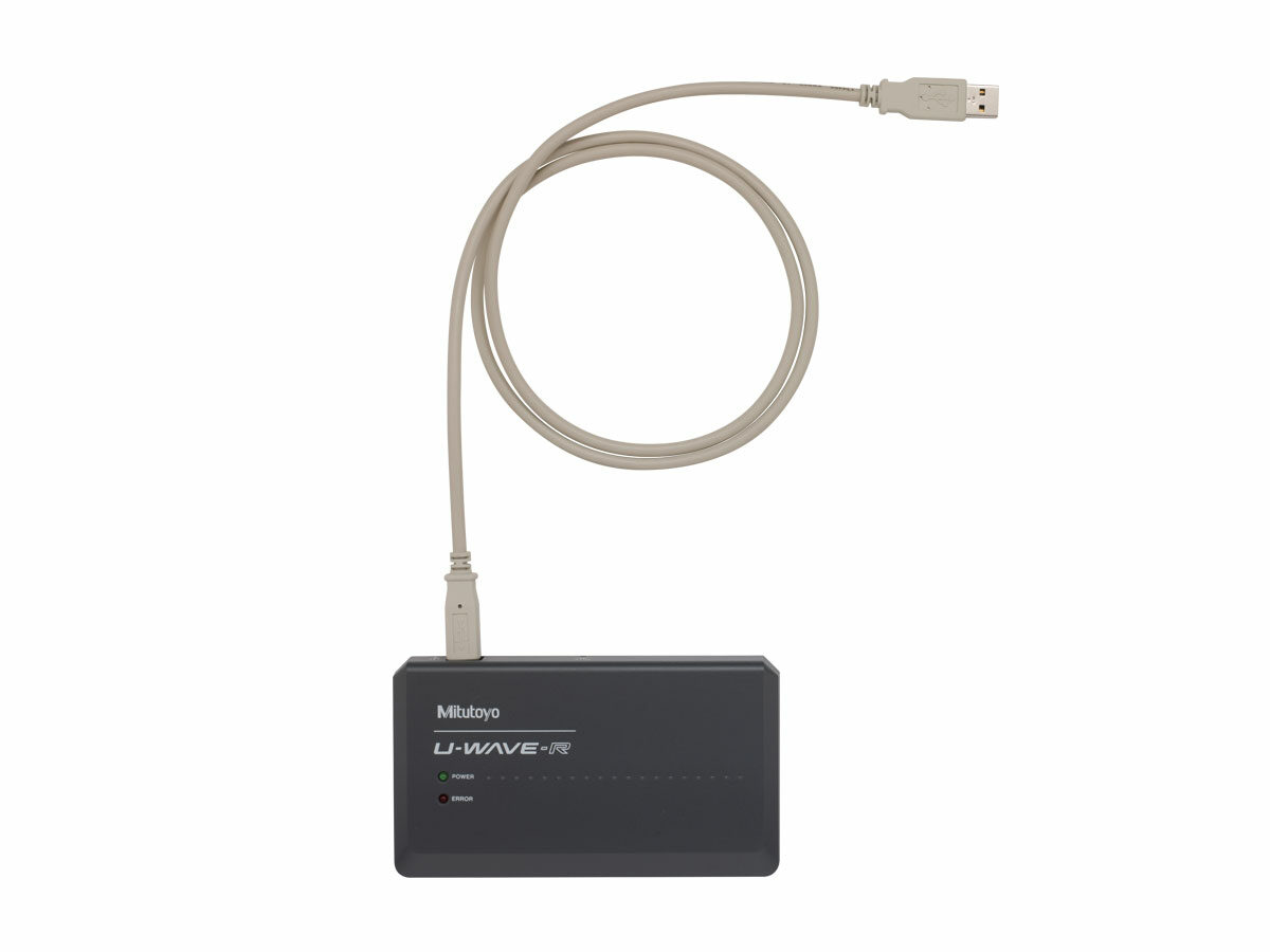

The Mitutoyo U-Wave-R wirelessly receives data measurements and transfers that data to a PC via USB connection.
The Mitutoyo U-Wave-R wirelessly receives data measurements and transfers that data to a PC via USB connection to store data. The data load function to Microsoft Excelâ„¢ is supplied as a standard accessory.
- Runs on USB power system; no battery or adapter is required
- The ID and frequency can be set using supplied software U-WAVEPAK
| Order No.: | Product Image: | Power Supply: | U-Wave Bluetooth Compatible: | Supported OS: | Number of U-WAVE-R units that can be connected to one PC: | Number of U-WAVE-T units that can be connected: | Outside Dimensions HxWxD: | Mass: |
| 02AZD810D | - | USB bus power system | No | Windows | Up to 15 | Up to 100 | 5.51 x 3.15 x 1.24" / 140 x 80 x 31.6mm | 130g |
