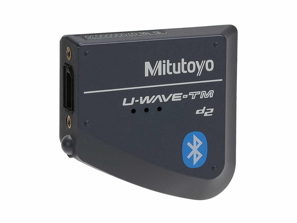

The Mitutoyo U-WAVE transmitter enables easy wireless data communication from a measuring tool to a PC using the Digimatic protocol. Measurement efficiency is improved by eliminating the long and cumbersome data cables.
The U-WAVE transmitter installs on to any Mitutoyo digital measuring tool and uses the Mitutoyo Digimatic protocol to easily transfer data measurements wirelessly to a PC. The use of U-WAVE eliminates the need for long, cumbersome data cables for much better measurement efficiency. The U-WAVE transmitters are available for Mitutoyo digital calipers, micrometers, indicators and height gages and transmit measurement data.
- User-friendly interface allows data to be loaded into any software product that accepts keyboard input, such as Microsoft Excel™ or Notepad
- Models are available using the Mitutoyo or BlueTooth™ protocols
- Available with LED and Buzzer/LED reception indicators
