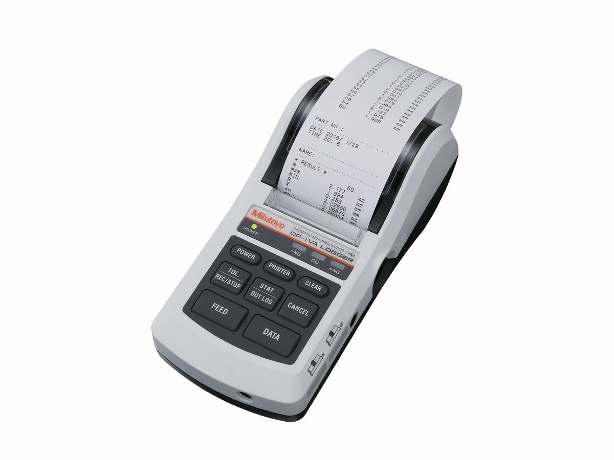

The Mitutoyo DP-1VA mini-processor and printer uses real-time measurement data from a Digimatic output measuring tool to perform complex statistical calculations such as those needed for Xbar-R control charts, histograms and D-charts.
The Mitutoyo DP-1VA Logger takes Digimatic measurement data in real time and can print the data for each part or send the information directly to a PC using a USB cable. The data collection is triggered by the button on the gage, cable, optional footswitch or the DP-1VA. The data logger stores up to 1,000 pieces of data in memory, and batch transfers stored data to an Excel-format inspection, etc. by connecting to a PC via a USB cable.
- DP-1VA can collect data unattended to measure changes over time
- Data collection can be triggered by a timer function
- Up to 1,000 measurements can be stored
- Go/no-go judgments are displayed on judgment lamps
- Up to five sets of Go/no-go judgments can be set
- Processor connects to a PC with USB micro-connector (optional, not included)
- Large keys are easy to operate
- Ability to print, save and send data

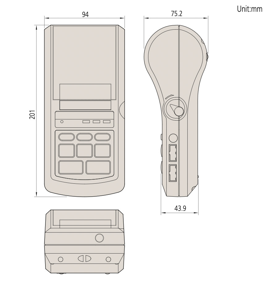

| Order No.: | Product Image: | Port for Footswitch: | Requires SPC Cables: | Data Input: | Printing method: | Print speed: | Print capacity: | Printer paper: | Power Supply: | Battery Life: | Data processing capability: Mode 0: | Data processing capability: Mode 1: | Data processing capability: Mode 3: | Total number of data entries: | Tolerance judgement: | Data storage: | Timer input (seconds): | Data output: | Operating Temperature Range: | Dimensions: | Required Accessories: | Optional Accessories: |
| 264-505A | - | Yes | Yes | Digimatic, Digimatic 2, RS-232C (KA Counter only) | Thermal line printer | 0.8s/line when using AC adapter | 7,000 lines/roll with large font, 10,000 lines/roll with normal font | 58 x 48 mm | AC Adapter, AA alkaline batteries X 4 (not included) | About 10,000 lines at 20 C | 100,000 entries | 9,999 entries | sample size 10 x subgroup 9,999 | 99,990 | 5 sets | Maximum 1,000 points | 0.25, 1, 5, 30, 60, 1800, 3600 | RS-232C, USB, Tolerance judgement | 0 / 45˚C | 94 x 201 x 75mm | - |
