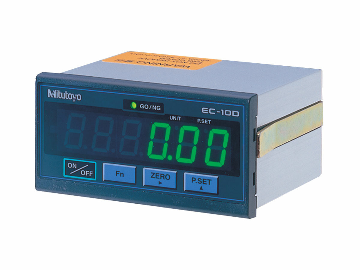

The Mitutoyo EC Counter Display Unit connects to digital measuring instruments providing Digimatic measurement data output and fast Go/no-go judgments on a large LED display.
The Mitutoyo EC Counter is a single-function multi-point display unit that shows measurements and quick Go/no-go judgments from digital measuring instruments. The unit’s DIN size and mount-on-panel configuration incorporates better into a system. The large LED display is ideal for low-light situations or when the scale is not optimally positioned.
- Connects to LGD, LGS and all SPC output gages
- Functions: preset and Go/no-go judgment
- Output: 3-step limit signal, normal signal
- Display size is 6 LEDs

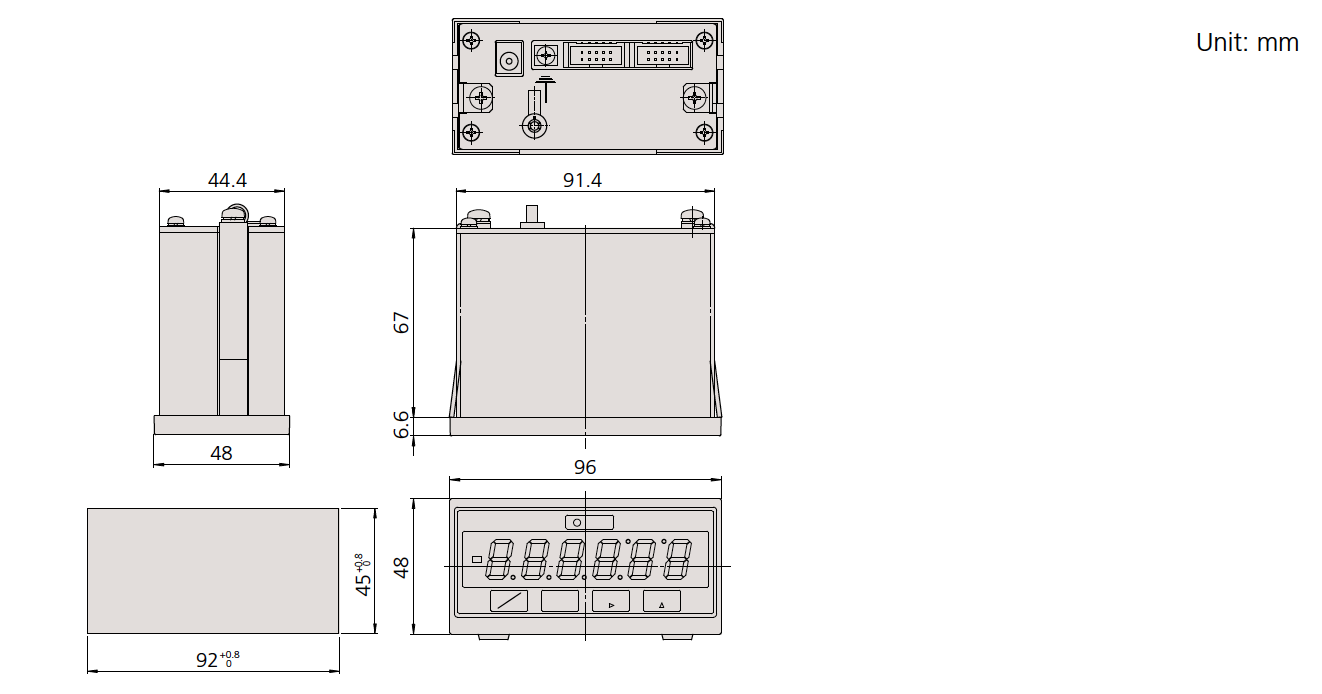

| 542-007A | - | LGD, LGS, All SPC output gages | .0001, .00005, .001, .005" / 0.001, 0.01mm | 1 | 6-digit LED | Preset, GO/NO-GO judgement | Open collector, 3-step limit signal, Normal signal | Preset, Data hold | AC Adapter | 96 x 48 x 84.6mm | 50g | Yes |
