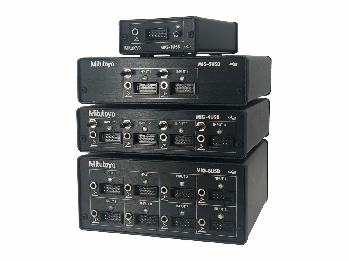

The Mitutoyo USB Multiplexer is a device that connects multiple gages with SPC Output directly to a PC via a USB cable.
The Mitutoyo USB Multiplexer is a device that connects multiple gages with SPC Output at an inspection station directly to a PC via a USB cable. The measurement gages connect to the Multiplexer with SPC cables, and the Multiplexer features switches on the inputs to select which gage sends measurement data to the computer. This saves a lot of time switching out gage SPC cables connected to the PC.
The benefits of a Digimatic Multiplexer also include:
- Ability to transfer data from all of the gages to a PC and into any software such as Excel™ or MeasurLink®
- Useful in multi-gage inspection stations as well as dedicated fixtures that use multiple Digimatic tools
- Reduces the number of connections required to the PC
- Supports keyboard Emulation (HID) or Virtual COM Port (VCP) and RS232 connections
- Multiplexer also supports Max, Min and TIR collection modes
