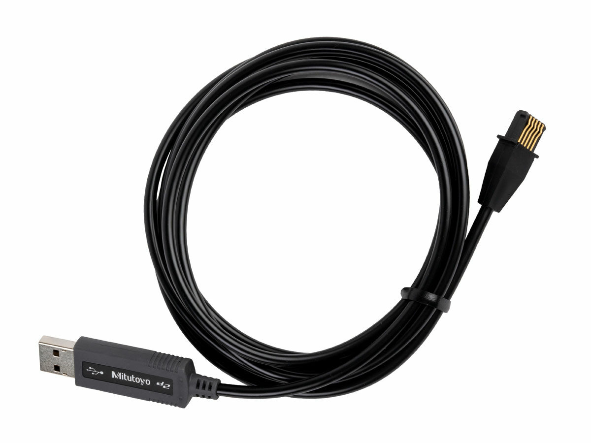

USB direct cables connect a Mitutoyo Digimatic measurement tool or instrument directly to a PC to transfer measurement data.
Mitutoyo USB direct cables connect SPC-output-enabled digital Mitutoyo micrometers, calipers, indicators and height gages directly to a PC. These single-piece cables are slim with smooth routing for improved workability.
- Simple plug and play, no drivers or software required to input data to the PC
- Some USB cables come with data switch
- Input data into Excel or any other software that accepts keyboard entry
