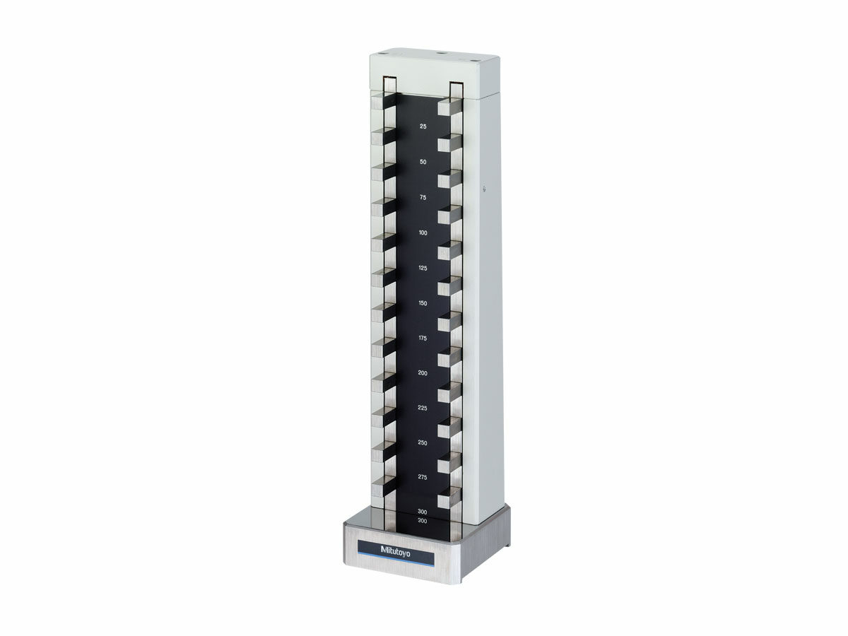

The Mitutoyo Depth Micro Checker accurately checks the zero point of depth gages.
Depth Micro Checker
The Mitutoyo depth micro checker efficiently and accurately checks the zero point of a depth micrometer and confirms reference measurements in increments of 25mm/1” depending on the model.

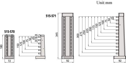

View Dimensions
The Depth Micro Checker is a reference gage used to take confirmation reference measurements in increments of 25mm/1” depending on the model. The micro checker also verifies and adjusts a depth micrometer’s base zero position. The micro checker is permanently wrung and features high-grade CERA gage blocks in a protective casting.
  • Available in 0-150mm, 0-300mm or 0-6”
  • Constructed of zirconia-based ceramic CERA measuring blocks that are dimensionally stable and corrosion resistant
Technology: Mechanical
Anvil block accuracy: ±0.5µm
Order No.: Product Image: Units: Range: Block pitch accuracy: Remarks:
515-570 Metric 0-150mm ±(1+L/150)µm 50, 100, 25, 75, 125, 150mm
515-571 Metric 0-300mm ±(1+L/150)µm 50, 100, 150, 200, 250, 300mm, 25, 75, 125, 175, 225, 275

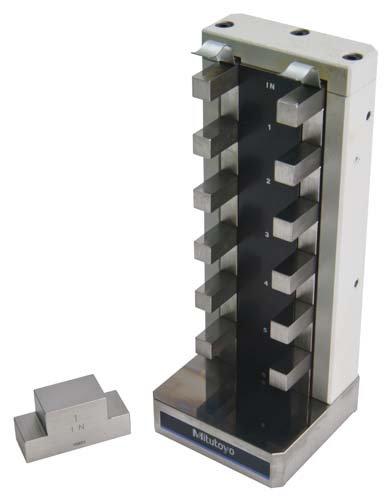

515-575 Inch 0-6" ±40+L/0.15" 2", 4", 6", 1", 3", 5"
