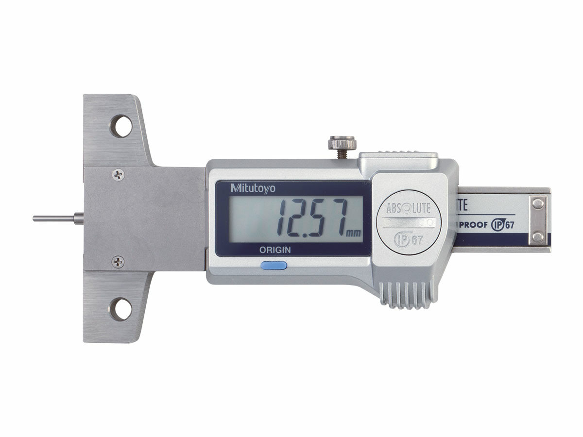

The Mitutoyo ABSOLUTE Digimatic tire tread depth gage is specially designed to measure tire tread depth with accuracy down to +/- 0.02mm/.0005”.
The Mitutoyo ABSOLUTE digital tire tread depth gage measures tire tread depth with high accuracy. Its size and light weight makes the gage easy to use. The gage scale, blade and measuring rod is constructed of hardened stainless steel for added durability. Measurements are displayed on a digital LCD readout with SPC output for easy automatic recording.
- Convenient mounting holes in the base for repeatable accuracy
- Keeps track of the origin point for the life of the battery
- SPC output function with optional water-resistant SPC cable allows for quick and easy data management in real time
- Functions include Origin Set, Zero Setting, Automatic Power On/Off and inch/mm conversion (on inch/metric models only)

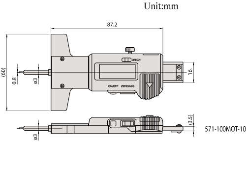

| Order No.: | Product Image: | Units: | Range: | Resolution: | Accuracy: | Optional Accessories: |
| 571-100-20 | - | Metric | 0-25mm | 0.01mm | ±0.02mm | - |
| 571-200-20 | - | Metric, Inch | 0-25mm / 0-1" | 0.01mm / 0.0005" | - | - |
