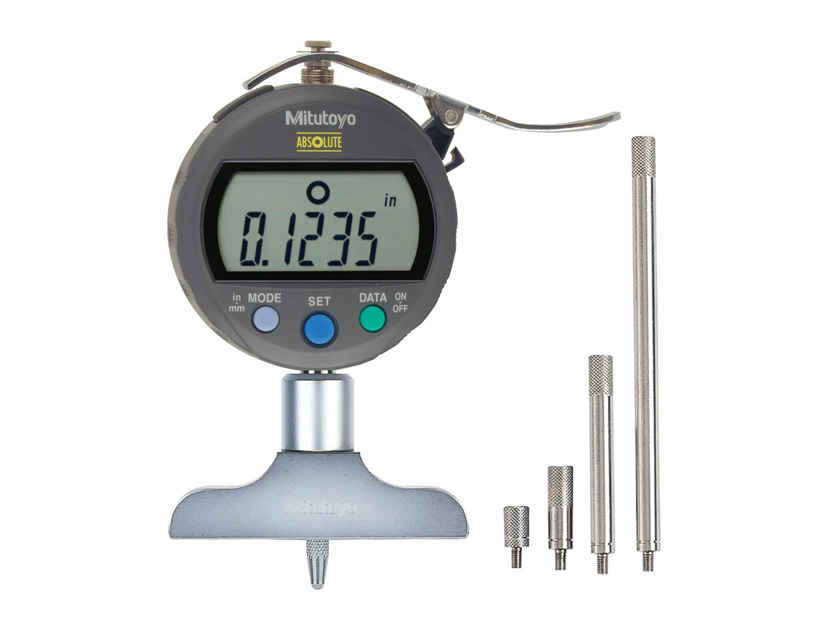

The ABSOLUTE Digitmatic Depth Gage taking a precise depth measurement of just 0.1235 inches.

The Mitutoyo ABSOLUTE Digimatic depth gage takes highly accurate depth measurements on a wide range of holes and depressions with the included extension rods.
