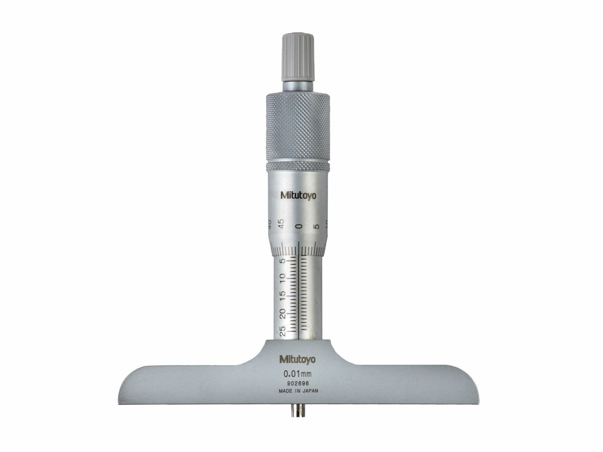

The Mitutoyo depth micrometer measures the depth of holes and depressions up to one-inch deep. A Vernier scale provides precise measurements in fine units.
Analog Depth Micrometer
The depth micrometer is ideal for fast, highly accurate depth measurements of up to 25mm/1”. The depth micrometer is constructed of hardened tool steel, and offers a ratchet stop mechanism which provides uniform pressure for precise, repeatable measurements.
- Available with carbide-tipped measuring rod
- Measuring rod clamp provides added stability for better accuracy, repeatability
- Satin chrome finish on thimble for better readability
- Rod diameters are 4mm
- Measuring rod clamps provide added measurement stability
- Supplied with a fitted plastic case
| Technology: | Mechanical |
| Parallelism between reference face and measuring rod face: | (4+L/50)µm, L=Max. measuring length (mm) |
| Measuring rod diameter: | 4mm |
