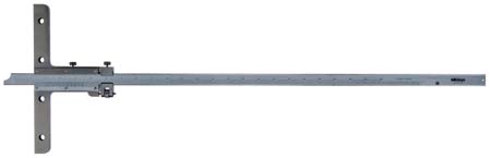

The Vernier Depth Gage precisely takes measurements in the style of a vernier caliper.
Vernier Depth Gage

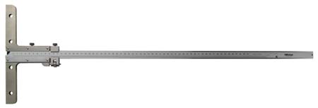

The Mitutoyo Vernier depth gage provides highly accurate depth measurements for any shape that has a step, groove or slot.

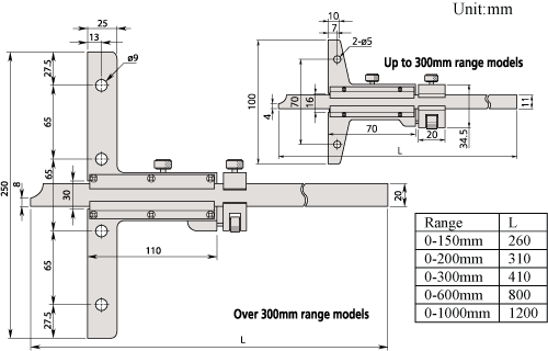

View Dimensions

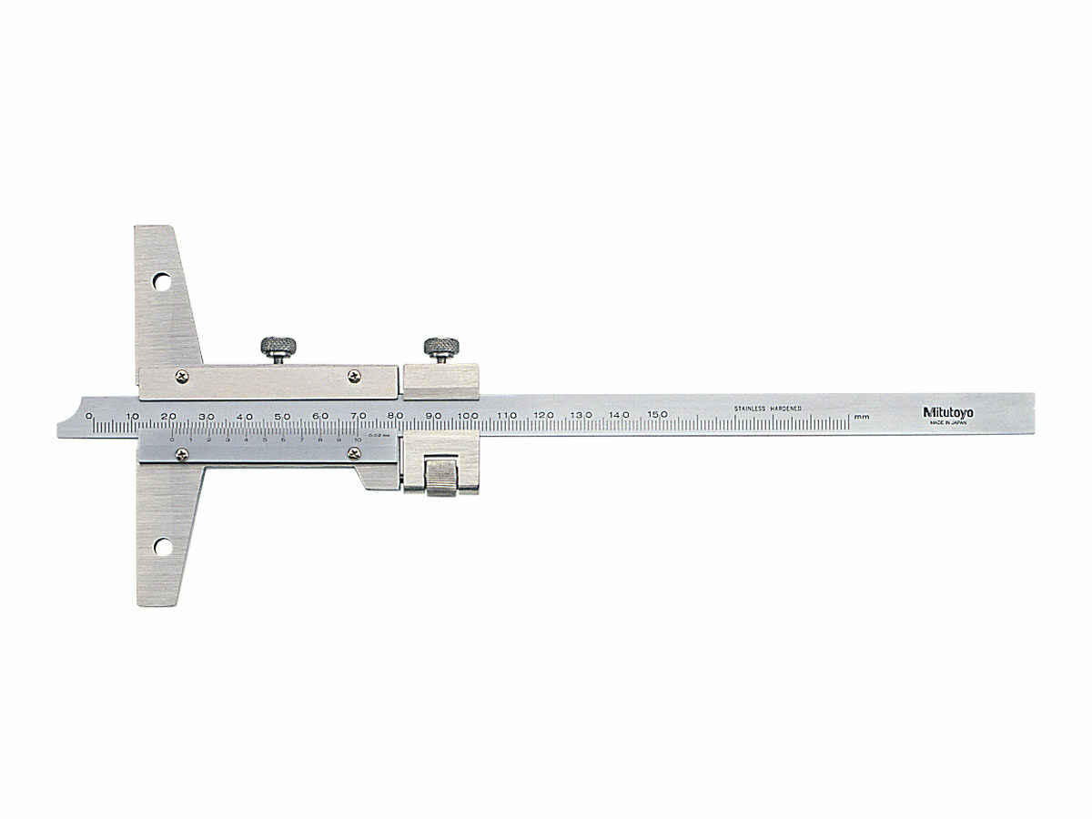

The Mitutoyo Vernier depth gage features hardened, micro-lapped measuring faces and base for improved accuracy and wear resistance. The depth gage is constructed of hardened stainless steel with a satin chrome finish for protection and easy reading. Wider extension bases (up to 450mm range models) are available if needed.
  • Some models have a fine adjustment screw for precision measurements
  • Constructed of corrosion-resistant, hardened stainless steel
  • Lock screw holds the slider in position for accurate measurement
  • Most models are supplied in fitted plastic case; 18”/450mm and 24”/60mm models are supplied in a wooden case
Technology: Mechanical
