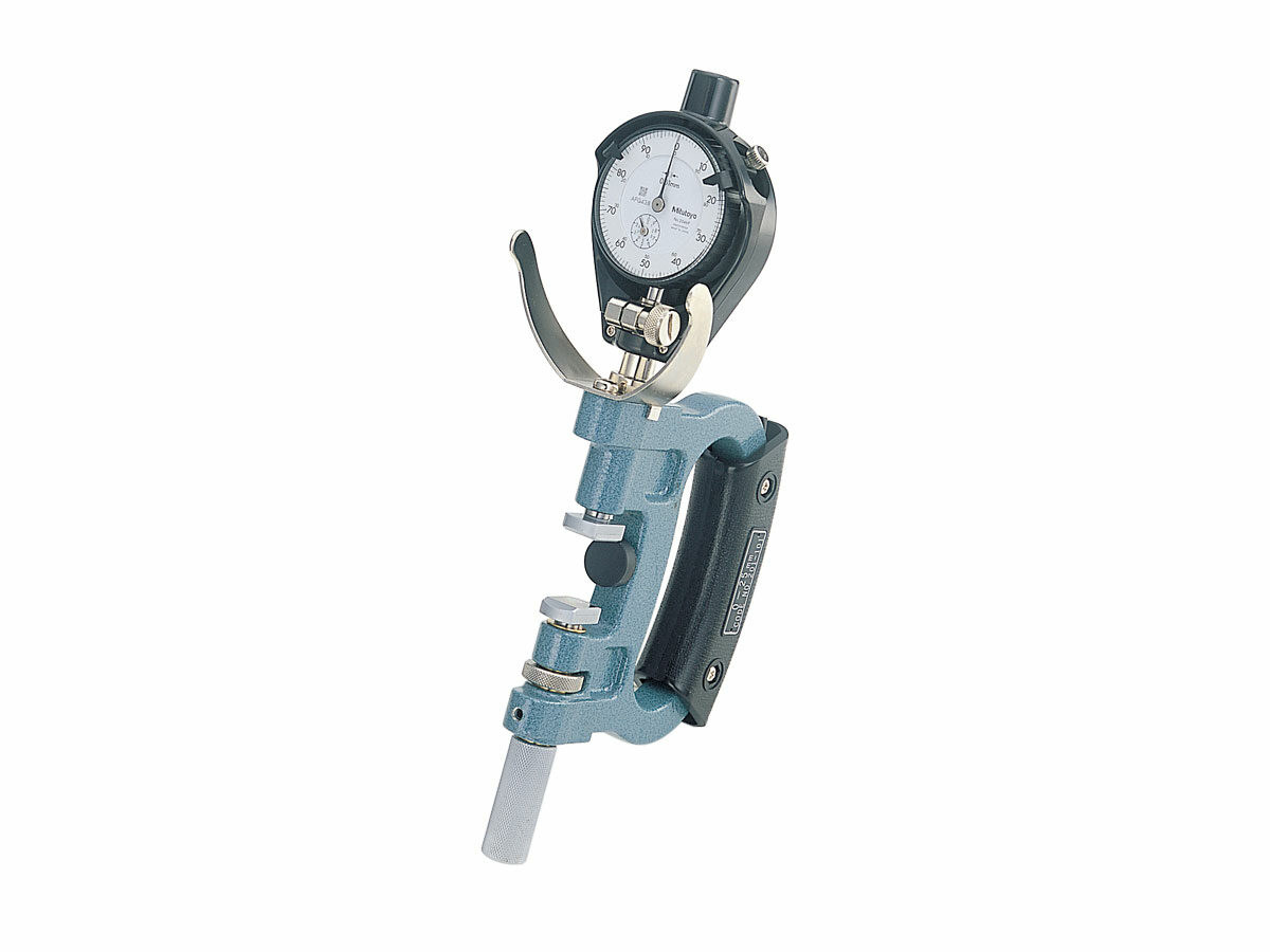

Dial Snap Gage
The Mitutoyo dial snap gage performs quick Go/No-Go judgments of cylinder and shaft diameters during the machining process. These gages can be used with optional Mitutoyo dial indicators (not included).
The Mitutoyo dial snap gage is designed to provide quick and easy Go/No-Go diameter judgments for cylinders and shafts. The gage’s frame and spindle is constructed of hardened steel that resists flexing and temperature fluctuations for more accurate, repeatable results. The hand grip allows for solid, secure handling of the gage while in use.
  • Dial indicator is not included with the snap gage
  • Metric and Inch models available
  • Recommended metric dial indicators include: 2046SB or 2109SB-10
  • Recommended inch dial indicator include: 2803SB-10
  • Anvil retracting stroke: 2mm/.078”
  • Anvil position range: 25mm/1”
  • Anvil surfaces are made of carbide for better durability
  • Both front edges of anvil are chamfered for easy insertion
  • Frame is powder coated
Technology: Mechanical
Measuring Force: 15N
