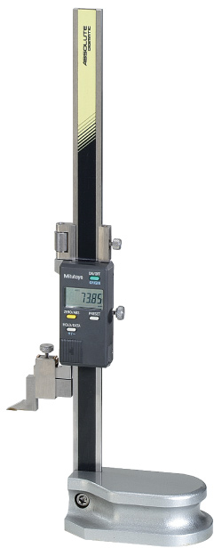

The Mitutoyo ABSOLUTE Digimatic Height Gage with ABSOLUTE Linear Encoder provides highly accurate height measurements in a convenient, easy-to-use system. Measurements are shown on a large LCD display.
The highly accurate Mitutoyo ABSOLUTE digital height gage uses a built-in ABSOLUTE linear encoder which eliminates the need to set the reference point during every power-on. The hand-operated slider with fine adjustment carriage offers smooth movement and precise measurement. Includes a carbide-tipped long scriber that provides highly durable and extremely accurate marks on your workpiece.
- Fine adjustment carriage for smooth movement

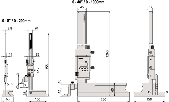

- Metric models are available in ranges: 0-200mm and 0-1000mm
- Inch/Metric models are available in ranges: 0-8”/0-200mm and 0-40”/0-1000mm
