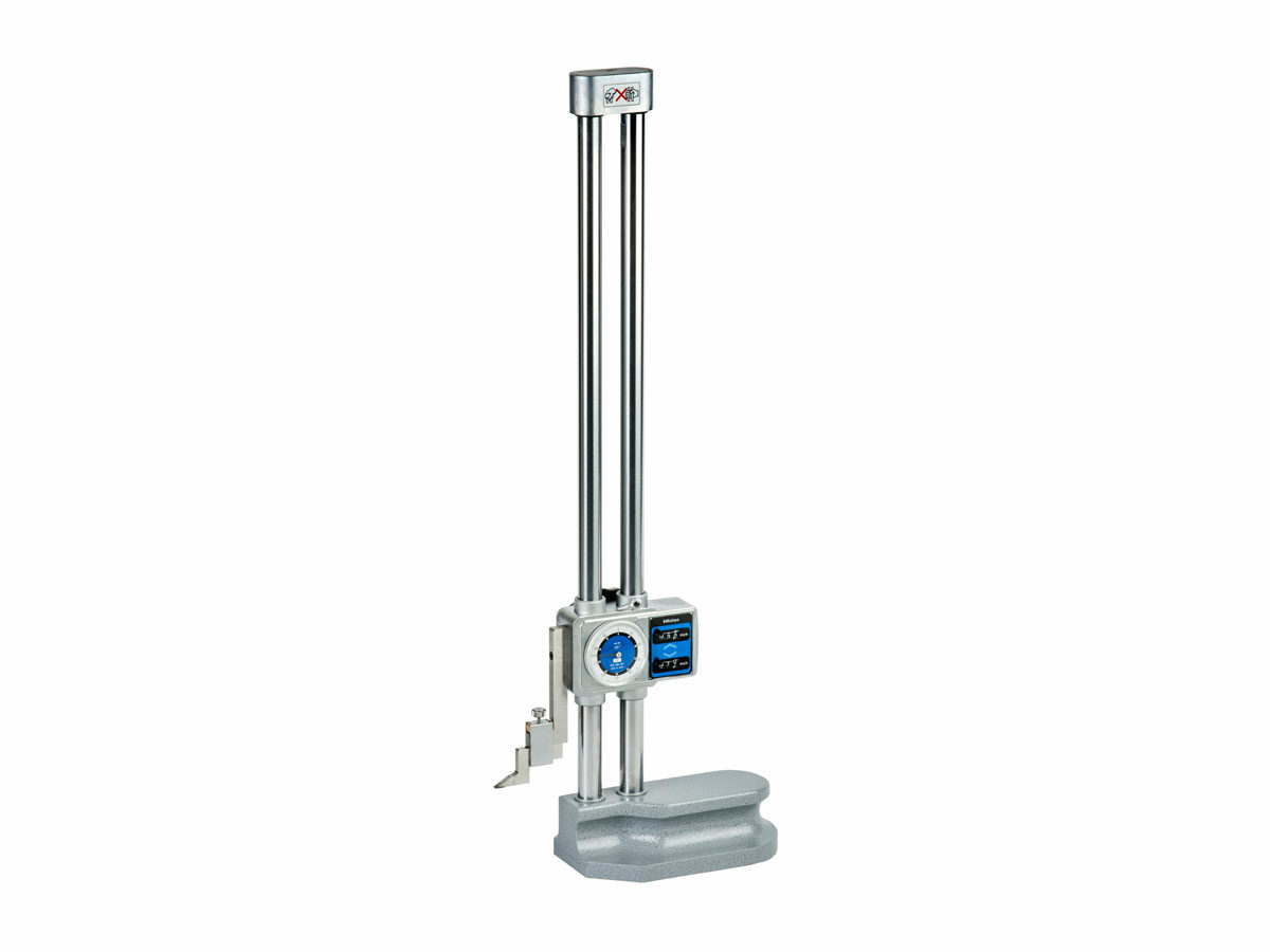

Dial Height Gage with Digital Counter
The Mitutoyo Dial Height Gage achieves highly accurate height measurements with improved ease of operation. Measurements are shown on a precision dial display with digital counter.
View Dimensions
The Mitutoyo dial height gage provides precise height in a unit that is easy to use. The height gage has a rigid, double-column structure which ensures high measuring accuracy and repeatability. The included carbide-tipped long scriber is highly durable and provides accurate marks on your workpiece. The dial and digital counters can be re-zeroed at any scriber position.
  • Models available in four different height ranges
  • Large function buttons on display are positioned for easy operation
  • Inclined slider handle improves slider ergonomics
  • Base is shaped to provide a secure grip
  • Coarse/fine feeding switch for fast adjustments and precise measurements

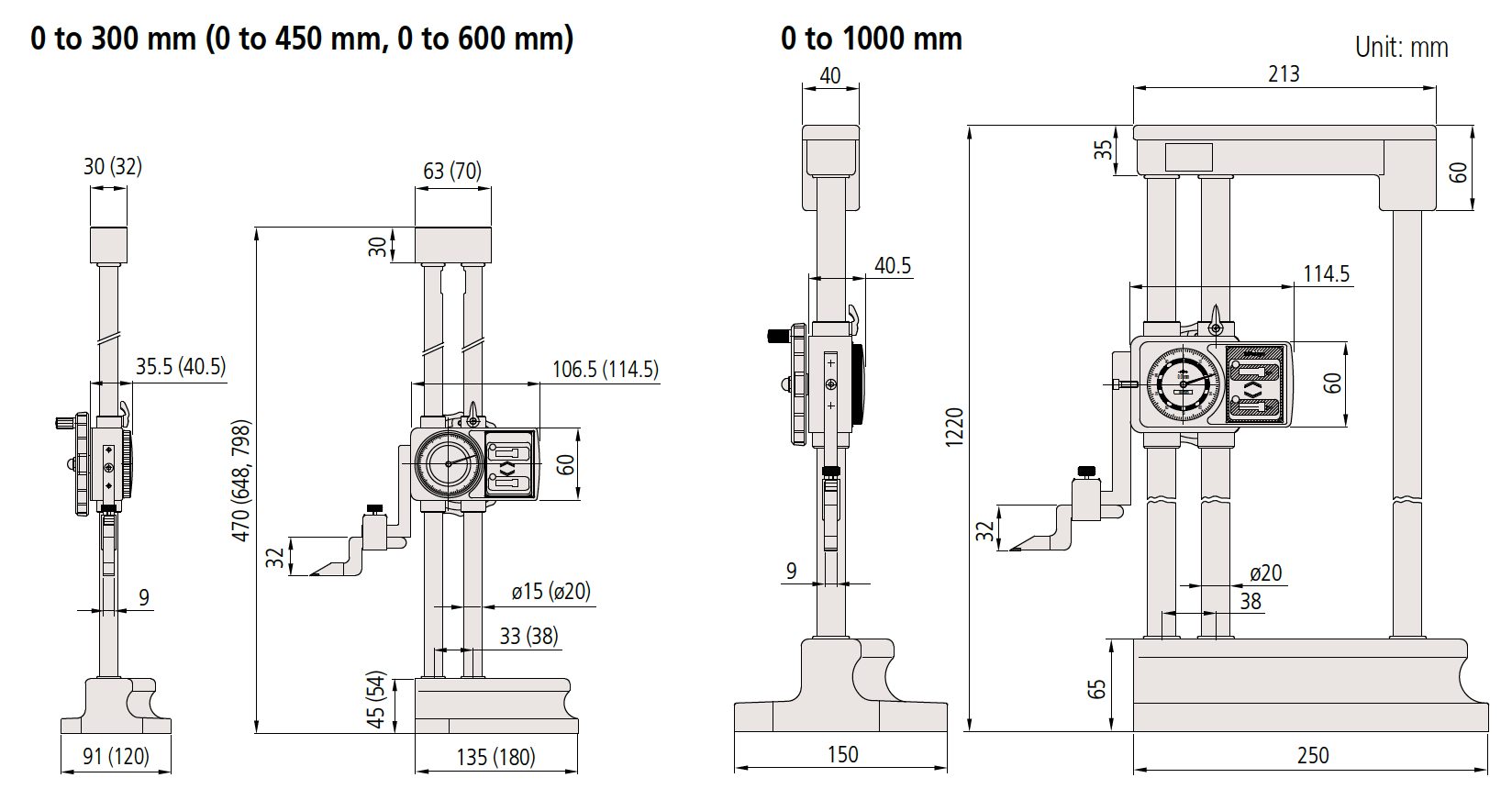

Order No.: Product Image: Units: Range: Accuracy: Graduation: Mass: Required Accessories:
192-130 - Metric 0-300mm ±0.03mm 0.01mm 4.2kg
192-131 - Metric 0-450mm ±0.05mm 0.01mm 9.2kg
192-132 - Metric 0-600mm ±0.05mm 0.01mm 9.7kg
192-133 - Metric 0-1000mm ±0.07mm 0.01mm 17.0kg
192-150 Inch 0-12" ±.0015" 0.001" 4.2kg
192-151 - Inch 0-18" ±.002" 0.001" 9.2kg
192-152 - Inch 0-24" ±.002" 0.001" 9.7kg
192-153 - Inch 0-40" ±.003" 0.001" 17.0kg
