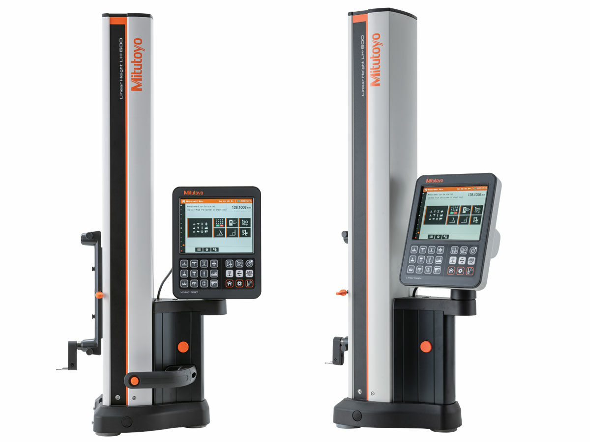

The Mitutoyo LH-600F Linear Height Measurement System is the latest model in the Mitutoyo Linear Height Gage line several added features and benefits including a rotatable touch screen interface, new self-check feature, an improved 2D mode and more all while maintaining reliability and accuracy.
The Mitutoyo LH-600F Linear Height Measurement System is the latest model in the Mitutoyo Linear Height Gage line with several new features along with best-in-class accuracy using a high-accuracy scale unit and high-accuracy guiding mechanism manufactured in our own Japanese facilities. The LH-600F now features a touch screen interface that allows for easy and intuitive operation, allowing users to measure with the press of a button or through touch screen icons. The rotatable and adjustable display of the LH-600F also allows for use from both front and rear orientations as well. There are new output options including a Digimatic output that allows data to be sent directly to Excel or SPC software, wired or wirelessly, while maintaining USB and RS232C output capabilities.
- A new self-check feature can detect dirt or oil on the encoder, ensuring the instrument is clean and able to provide accurate measurements
- Instant changes to units, resolution and delta measurement from the previous reading can now be made
- An air bearing system makes it easy to move the height gage around; a semi-float mode allows it to slide more easily while taking measurements, even with heavy parts
- Motorized capabilities provide better repeatability and reproducibility along with improved 2D mode to measure angles, bolt hole circles and more
- A new optional footswitch is available for hands-free repeat measuring of volume parts
- Multiple probe options (optional) and probe position is switchable for better perpendicularity and straightness measurements
- Excellent accuracy of (1.1+0.6L/600)μm with 0.1μm/0.5μm resolution/repeatability
- Available in Inch/Metric models
