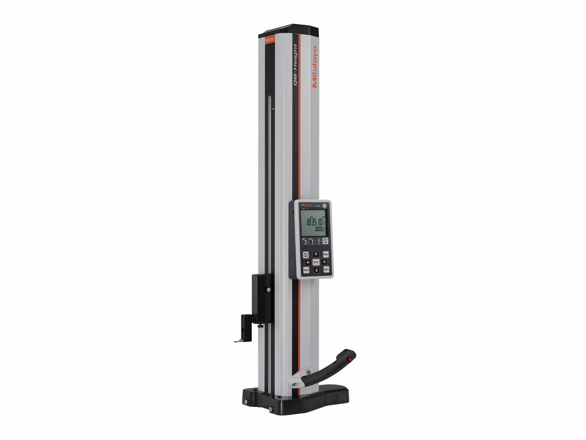

The Mitutoyo QM Height ABSOLUTE digital height gage provides great versatility with height and other types of measurements. Measurements are displayed on a large, easy-to-read LCD readout.
The Mitutoyo QM Height high-performance height gage takes height, step, inside and outside widths, inside and outside diameters, and circle pitch with great precision. Perform Go/No-go judgements by setting upper and lower tolerances, and out-of-tolerance measurements change the display background from green to red for quick reference. The QM Height’s ABSOLUTE electromagnetic induction-type linear scale maintains the measurement position until it is reset by the operator.

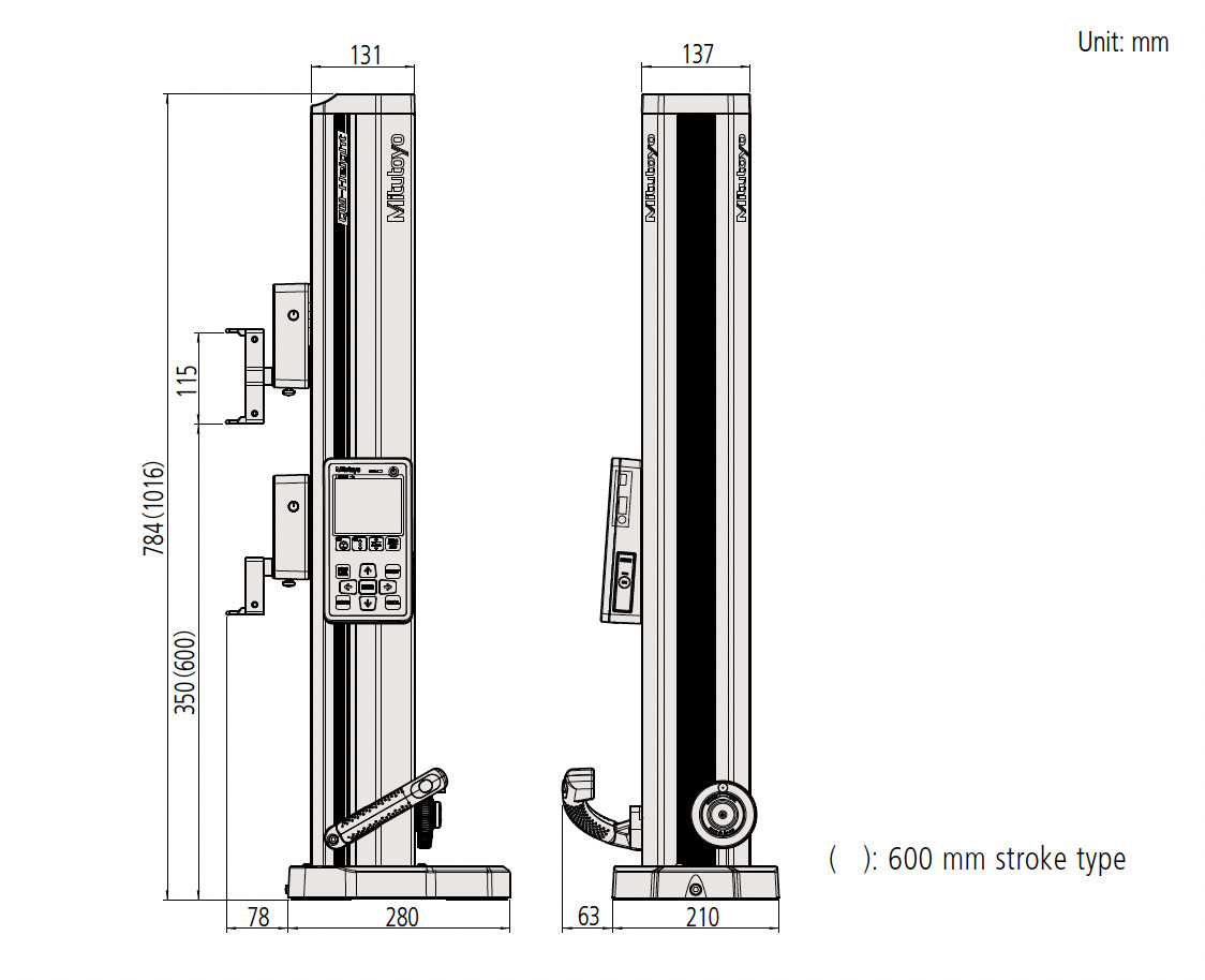

| Order No.: | Product Image: | Units: | Range: | Mass: | Floating Method: | Dimensions: |
| 64PKA094B | - | Metric, Inch | 0-465mm / 0-18" | 55.16 lbs / 25kg | N/A | 41.85 X 21.85 X 18.94" / 1063 X 555 X 481mm |
| 64PKA095B | - | Metric, Inch | 0-715mm / 0-28" | 63.93 lbs / 29kg | N/A | 51.02 X 21.85 X 18.94" / 1296 X 555 X 481mm |
| 64PKA129B | - | Metric, Inch | 0-465mm / 0-18" | 57.32 lbs / 26kg | Included (for movement only) | 41.85 X 21.85 X 18.94" / 1063 X 555 X 481mm |
| 64PKA130B | - | Metric, Inch | 0-715mm / 0-28" | 66.14 lbs / 30kg | Included (for movement only) | 51.02 X 21.85 X 18.94" / 1296 X 555 X 481mm |
