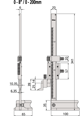

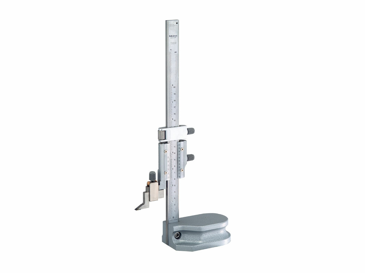

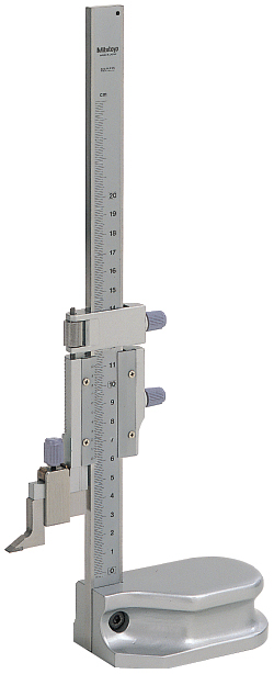

Vernier Light Weight Height Gage
The Mitutoyo lightweight Vernier Height Gage has a second sliding scale to take highly precise height measurements and is designed for scribing small parts.
View Dimensions
The Mitutoyo lightweight Vernier height gage is ideal for small parts and offers portability without sacrificing accuracy or durability. The slider and beam are constructed of hardened stainless steel, and the beam is adjustable with a ring-type lock nut to support repositioning of the zero reference point. The hand-operated slider features a fine-adjustment carriage with a calibrated screw mechanism for fine, uniform slider adjustments. The Vernier second sliding scale provides measurements between marks on the main scale for ultra-precise readings.
  • Optional magnifier is available for easier reading
  • Zero reference point can be adjusted for manual change of the base position
  • Scriber is carbide tipped for accuracy and durability
  • Scales have a satin chrome finish to reduce glare for easier reading
  • Base is shaped to allow a secure grip
  • Fine feeding carriage provides precise measurements
Technology: Mechanical
Mass: 1.4kg
Required Accessories: -
Optional Accessories: 900322, 953639
Order No.: Product Image: Units: Range: Accuracy: Graduation:
506-207 Metric 0-200mm ±0.03mm 0.02mm
506-208 Metric, Inch 0-200mm / 0-8" ±.001" 0.02mm / 0.001"
