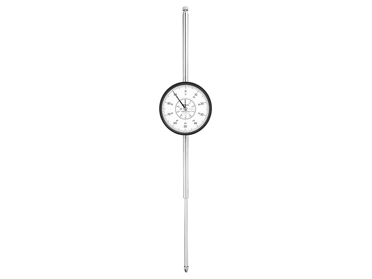

The Mitutoyo Series 3 large diameter, long stroke dial indicator measures surface variations with great accuracy displayed on an easy-to-read dial face.
Large Dial Face and Long Stoke-Series 3
The Mitutoyo large dial face dial indicator combines excellent accuracy and reliability with a large, easy-to-read dial face. The stem design provides a long clamping range for use in many different applications. The spindle and stem are constructed of hardened, high-strength steel, and the jeweled bearing provides wear resistance and low friction movements for smooth, precise operations. The absence of a through screw hole helps protect the indicator against water and oil permeation. The crystal has a scratch and glare-resistant coating for clearer readings and better durability. The outer clamp and optional lifting lever can be attached to either side and can be easily installed or removed without the use of tools.
- Offered with flat back or lug back for mounting purposes
- Bezel diameter: 78mm
- A revolutionary offset spindle bushing design provides trouble-free stem clamping and a longer clamping range
- Some models have a unique shock-proof mechanism which protects against shock from sudden spindle retraction
- Includes rotating bezel
- Rack gear is machine ground for tighter fit, increased accuracy
- Greater rigidity in the bearing plate reduces retracing error by up to 20%
- 4-Screw mounting increases impact resistance for better, longer accuracy
- No through screw hole on the frame provides better dust resistance
- Contact point is carbide tipped for lasting accuracy, durability
- Manufactured to meet ANSI/AGD and ISO/JIS standards
