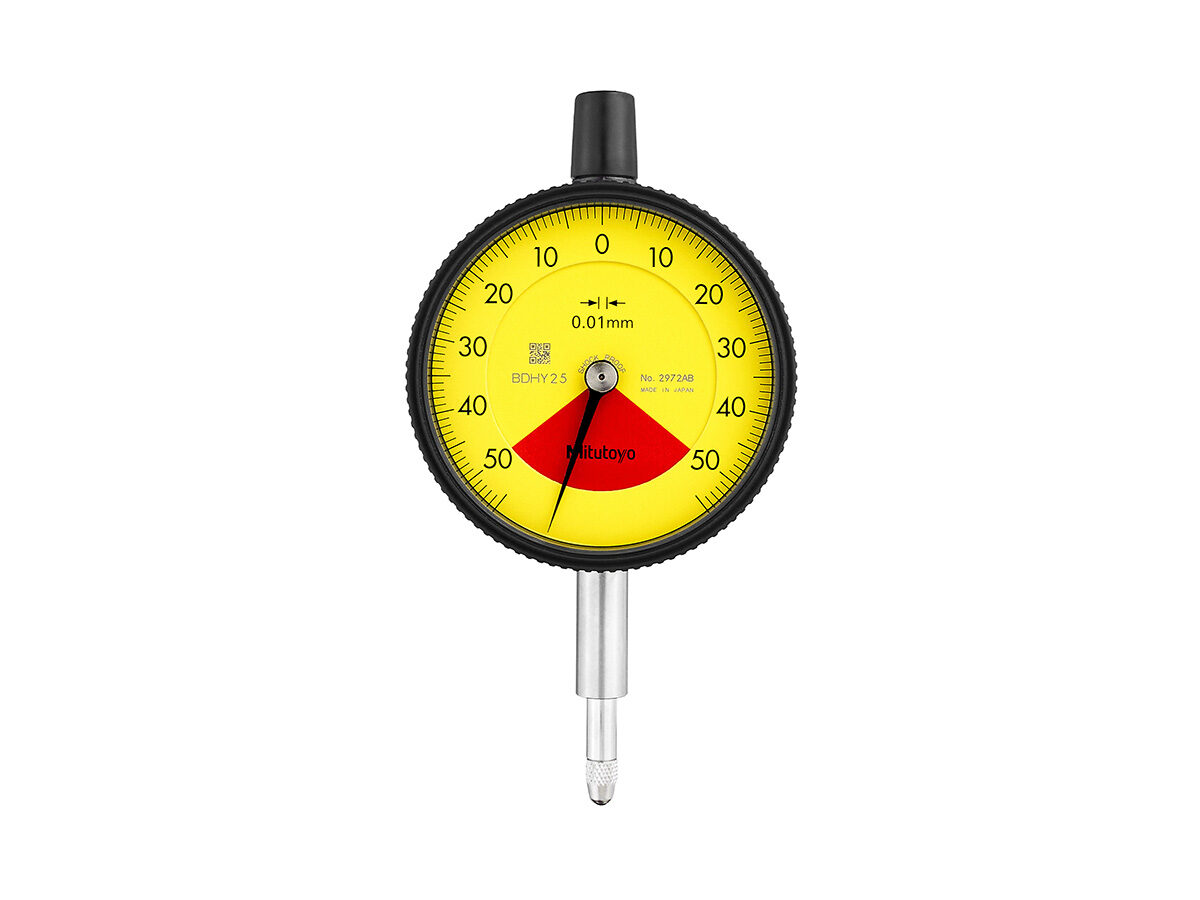

The Mitutoyo standard diameter-sized, single-revolution dial indicator offers complete measurement with one sweep of the hand to eliminate miscounting errors on an easy-to-read scale. Conforms to ISO/JIS standards.
Metric Standard One Revolution-Series 2
The Mitutoyo one revolution dial indicator allows the entire spindle travel, or range, with one sweep of the hand. This eliminates the possibility of reading errors from miscounting multiple hand revolutions. The one-revolution indicator is ideal for determining if a spindle range is within or outside a tolerance. The jeweled bearing provides great wear resistance and low friction movements for smooth, precise operations. The stem and spindle are constructed of hardened steel for better durability. The glare-free crystal has a scratch-resistant coating for clearer readings and better durability. A revolutionary offset spindle bushing design provides trouble-free stem clamping and a longer clamping range.
- Available in Metric models only
- Available in eight different ranges and four graduations
- Bezel diameter: 57mm
- Offered with flat back or lug back for mounting purposes
- Unique shock-proof mechanism protects against shock from sudden spindle retraction
- Includes green limit markers for quick, easy tolerance judgments
- Thumb screw bezel lock is easy-to-use for zeroing
- Rack gear is machine ground for tighter fit, increased accuracy
- Greater rigidity in the bearing plate reduces retracing error by up to 20%
- 4-Screw mounting increases impact resistance for better, longer accuracy
- No through screw hole on the frame provides better dust resistance
- Contact point is carbide tipped for lasting accuracy, durability
- Indicator has improved resistance to shop-floor contaminants such as water and dust
- Indicator is about 40% lighter than a conventional dial indicator
- Manufactured to meet ISO/JIS standards
