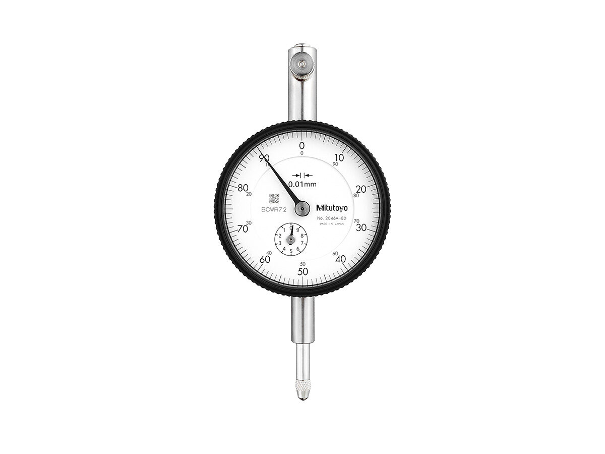

The Mitutoyo adjustable hand dial indicator can adjust the hand position independently of the vertical movement of the spindle for easy zeroing. Conforms to ANSI/AGD or ISO/JIS (specific metric models only) standards.
Special Dial Indicators-Series 2
The Mitutoyo adjustable hand special dial indicator adjusts independently of the vertical movement of the spindle by rotating the top knob which allows for easy zeroing and setting in any position. The jeweled bearing provides great wear resistance and low friction movements for smooth, precise operations. The stem and spindle are constructed of hardened steel for better durability. The green dial face is easy to read and reduces glare, and the crystal has a scratch- and glare-resistant coating for clearer readings and better durability. A revolutionary offset spindle bushing design provides trouble-free stem clamping and a longer clamping range.
- Metric and Inch models available
- Available with flat back or lug back for mounting purposes
- Unique shock-proof mechanism protects against shock from sudden spindle retraction
- Thumb screw bezel lock is easy-to-use for zeroing
- Rack gear is machine ground for tighter fit, increased accuracy
- Greater rigidity in the bearing plate reduces retracing error by up to 20%
- 4-Screw mounting increases impact resistance for better, longer accuracy
- No through screw hole on the frame provides better dust resistance
- Contact point is carbide tipped for lasting accuracy, durability
- Manufactured to meet ANSI/AGD or ISO/JIS (metric only) standards
