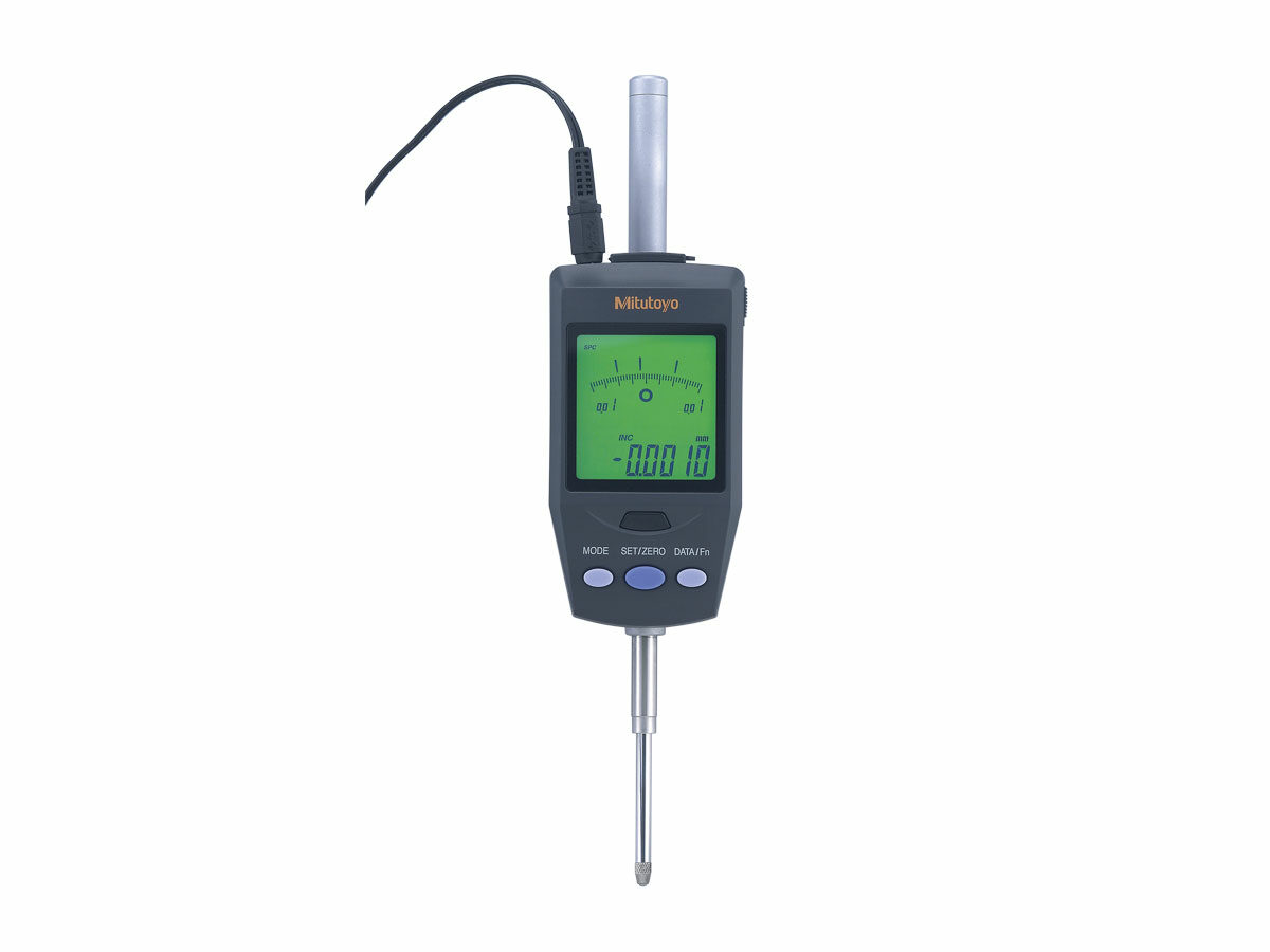

ABSOLUTE Digimatic High Function, High Accuracy Indicator ID-H
The Mitutoyo ABSOLUTE Digimatic ID-H high accuracy, high function indicators provide the latest technologies to give this indicator series the highest accuracy possible and the most functionality available in its class.
View Dimensions
The Mitutoyo ABS ID-H Series digital indicator offers excellent accuracy and robust functionality to make precise, repeatable linear measurements of up to 30.4mm/1.2”. The ID-H indicator has five user-selectable resolutions, and zero can be set at any spindle position for measuring in either plus or minus directions or both directions. The indicator displays maximum and minimum read hold and changes color from green to red when user-defined tolerances are exceeded. There is also a total indicator reading (TIR) function that displays the absolute difference between the highest and lowest readings. Remote control functionality is available with an optional handheld controller (21EZA099).
  • Use remotely via a handheld controller or RS-232C interface
  • The high-speed detector measures 100 times per second
  • Signal can be outputted to an external device
  • Analog bar provides easy-to-read values when scanning for Max, Min and TIR values
  • Go/No-Go judgements are performed by setting the upper and lower tolerances
  • Functions include: Remote control, origin set/preset, zero-set, Go/No-Go judgement, max/min value hold, analog bar, runout measurement, resolution switching, counting direction switching, power On/Off, data output and inch/mm conversion (on inch/metric models only)
  • Measurements are shown on a large, easy-to-read LCD display
  • Sealed housing meets IP30 rating for dust and water protection

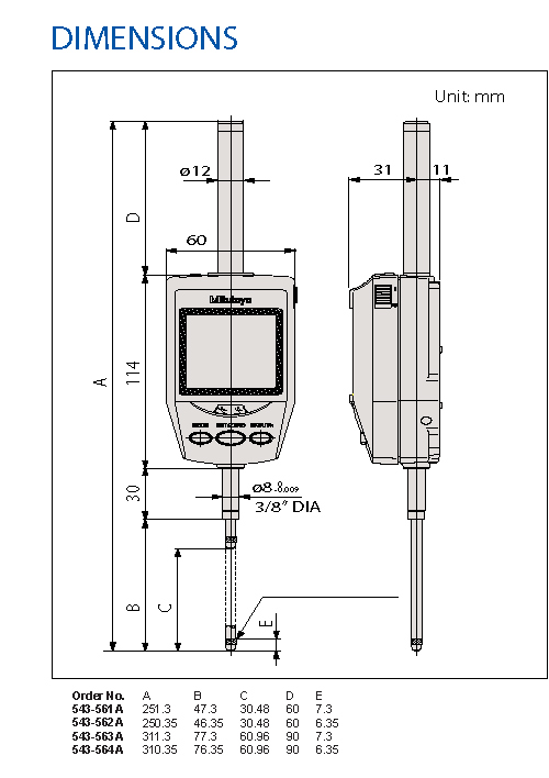

Order No.: Product Image: Units: Min Range: Max Range: Resolution: Accuracy: Stem diameter: Thread type: Measuring Force:
543-561A Metric 0mm 30.4mm 0.001, 0.00005mm ±0.0015mm 8mm M2.5 X 0.45 2.0 or lessN
543-562A - Metric, Inch 0" / 0mm 1/2" / 30.4mm .00002, .0001, .00005" / 0.001, 0.00005mm ±0.0015mm 3/8" 4-48 UNF 2.0 or lessN
543-563A - Metric 0mm 60.9mm 0.001, 0.00005mm ±0.0025mm 8mm M2.5 X 0.45 2.5 or lessN
543-564A Metric, Inch 0" / 0mm 2.4" / 60.9mm .00002, .0001, .00005" / 0.001, 0.00005mm ±0.0025mm 3/8" 4-48 UNF 2.5 or lessN
