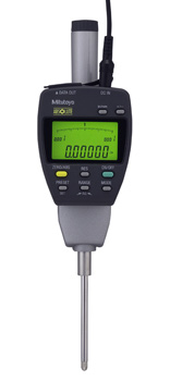

The Mitutoyo ABSOLUTE Digimatic ID-F indicator combines great accuracy and functionality with a back-lit LCD screen for fast Go/No-Go readings.
The Mitutoyo ABS ID-F Series digital indicator features a back-lit, easy-to-read LCD screen that changes from green to red when user-defined tolerances are exceeded. This allows Go/No-Go judgments much faster and easier without sacrificing accuracy or reliability. The ID-F indicator has six user-selectable resolutions with a maximum resolution of 0.001mm/.0005” and an accuracy of +/ 0.003mm/.00012”. An integrated analog bar indicator handles upper and lower limit approaching and zero approaching.
  • Inch Metric model ranges: 0-25.4mm/0-1”, 0-50.8mm/0-2”
  • Metric only model ranges: 0-25mm and 0-50mm
  • Go/No-Go judgements are performed by setting the upper and lower tolerances; screen turns from green to red when a tolerance is exceeded
  • SPC output function allows for easier, faster data management in real time
  • Functions include: Origin set/preset, zero-set, Go/No-Go judgement, max/min value hold, analog bar, runout measurement, resolution switching, counting direction switching, power On/Off, data output and inch/mm conversion (on inch/metric models only)
  • Sealed housing meets IP30 rating for dust and water protection
