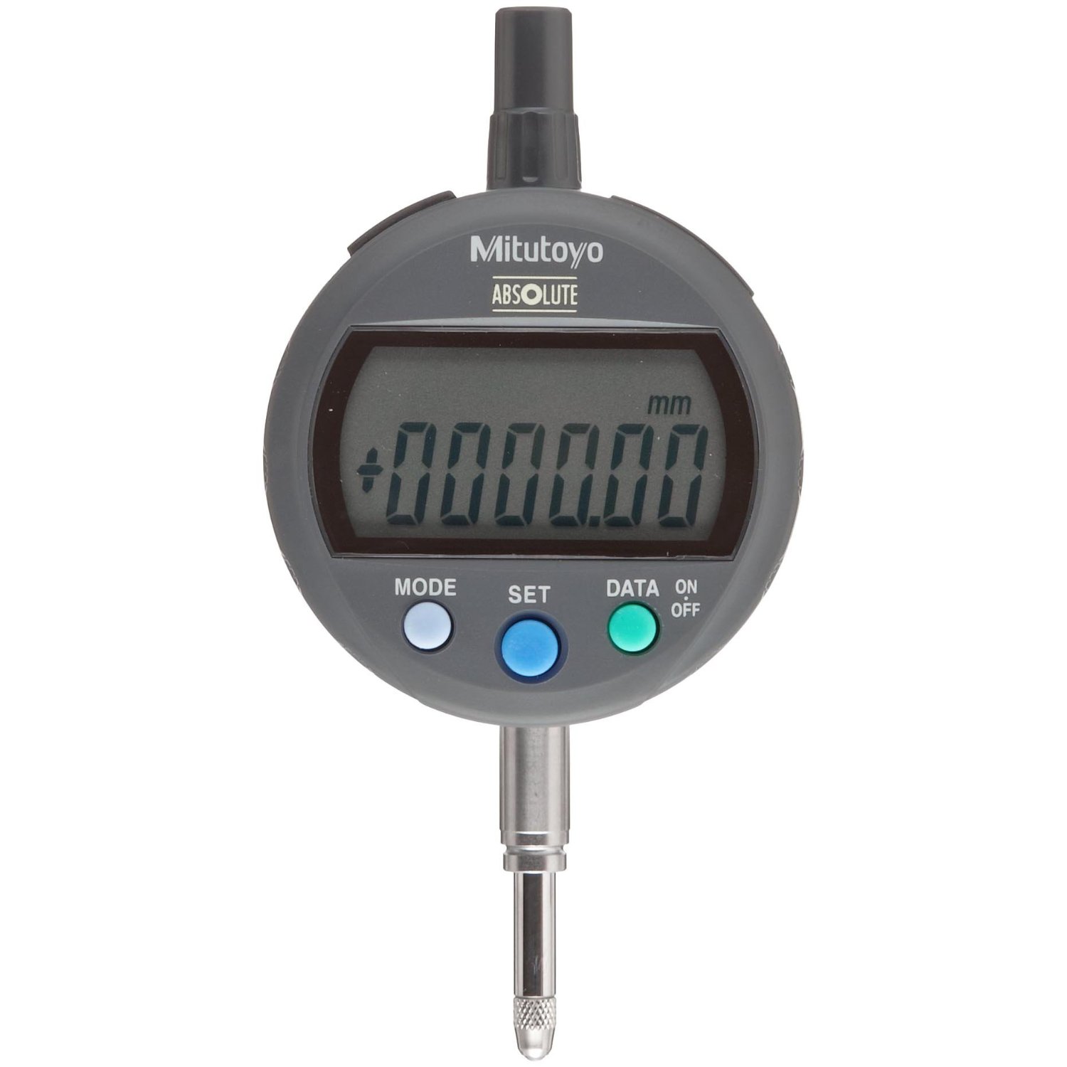

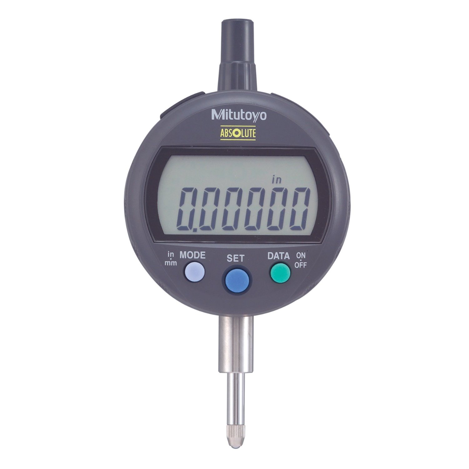

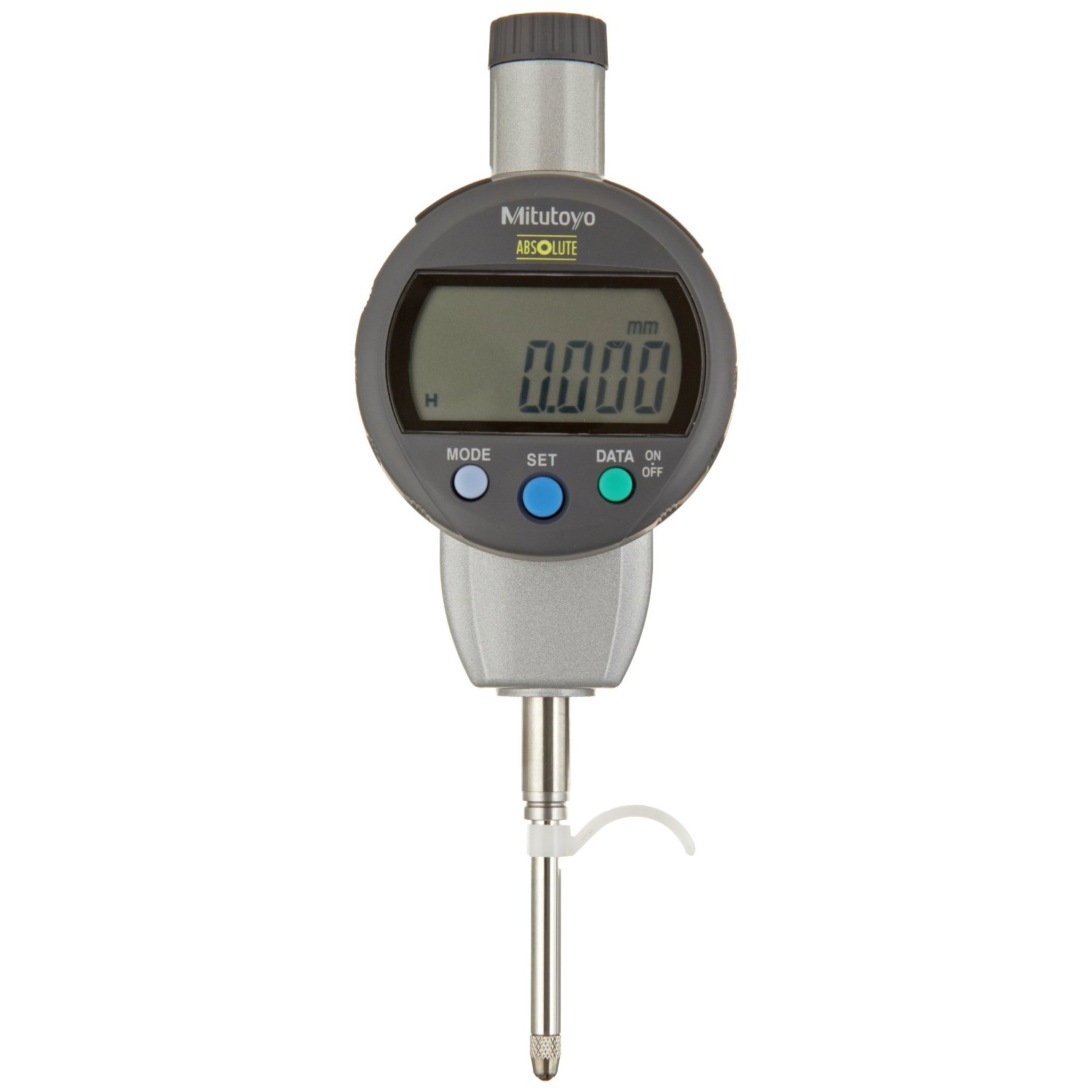

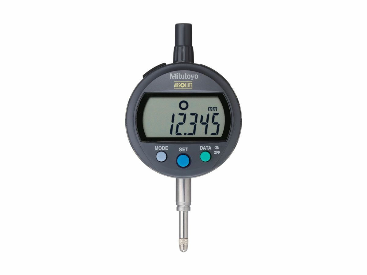

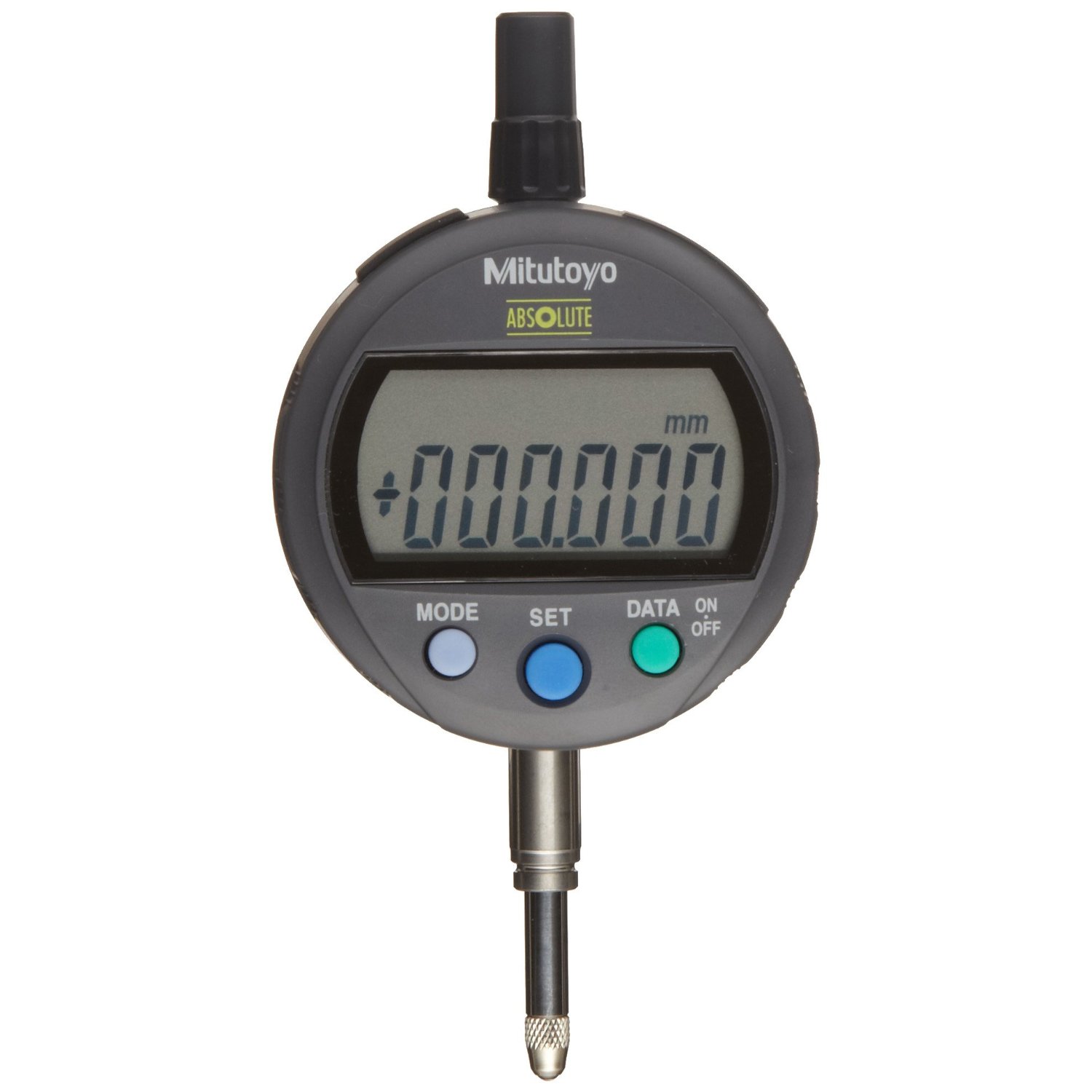

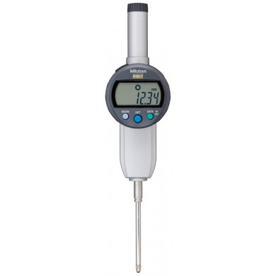

ABSOLUTE Digimatic Indicator ID-C

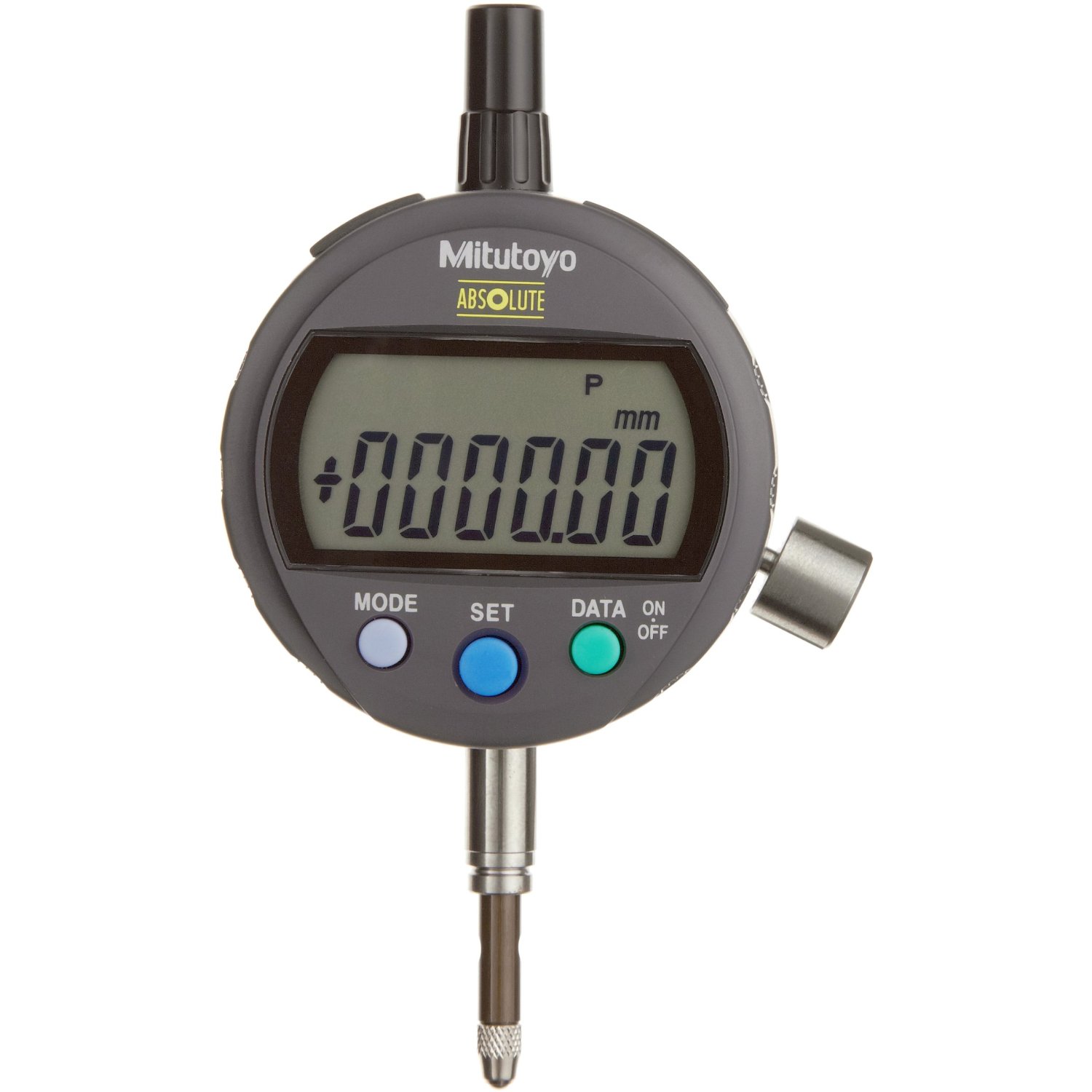

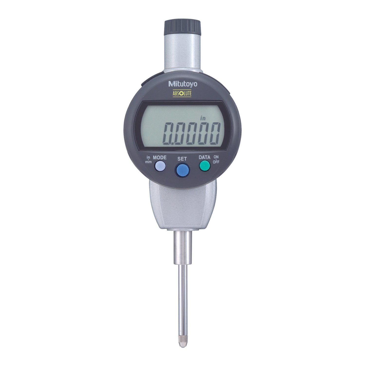

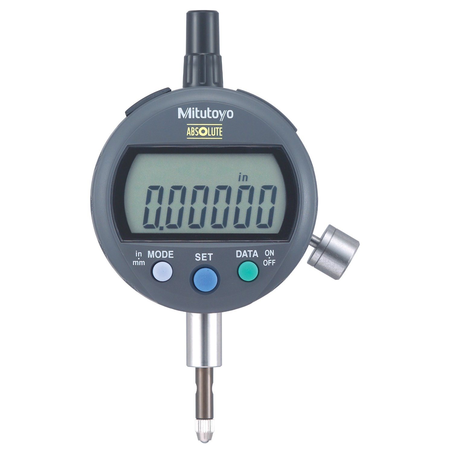

The Mitutoyo ABSOLUTE Digimatic ID-C standard-type indicators are highly accurate for short linear measurements and provide Go/No-Go judgements. Measurements are shown on an impact-resistant LCD display.
The Mitutoyo ABS digital ID-C standard-type digital indicators provide up to a 12.7mm / .5″ range in a compact design that is easy to use and read. The ID-C indicator’s face can rotate 330° to enable easier readings on the large 9mm LCD display from nearly any angle. Large push buttons provide direct, easy access to all of the indictor’s functions, and the positive/negative count from the spindle’s up/down movement can be toggled. The ABSOLUTE sensor automatically restores the last origin position when the indicator is turned on, allowing for quick-start operation which is useful in multipoint measurements.
  • Similar in size to standard Series 2 dial indicators
  • G0/No-Go display lights red or green when upper and lower tolerances are set
  • Internal calculations using the simple formula of [F(x)=Ax] are available
  • Functions include Origin set, zero set, Go/No-Go judgement, counting direction switching, power On/Off, data output and inch/mm conversion (on inch/metric models only)
  • IP42 for protection against objects greater than 1mm and water

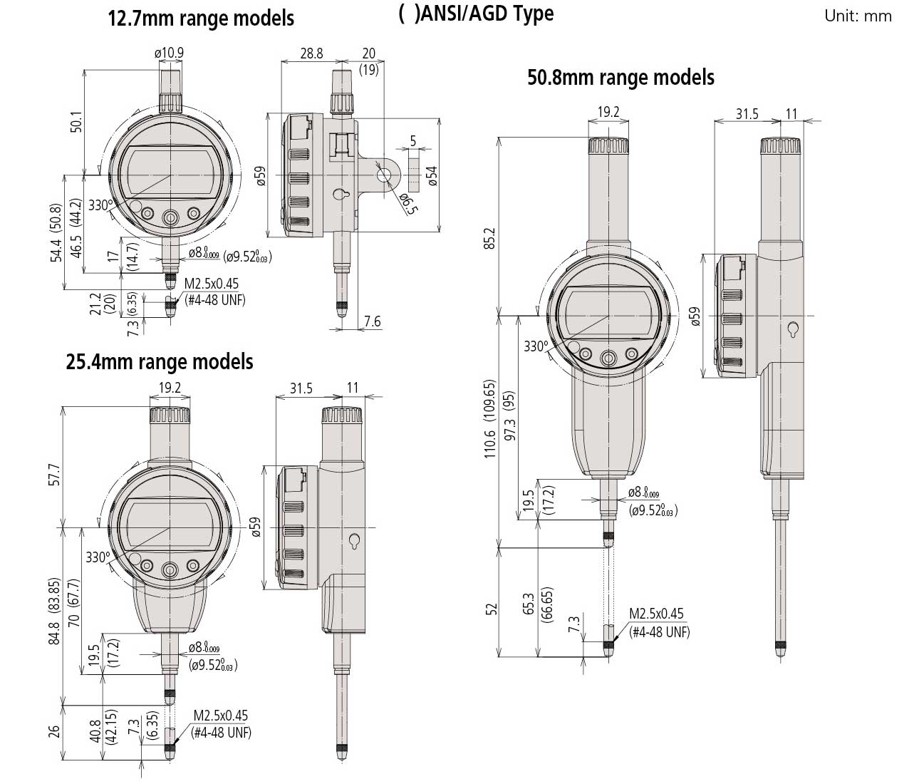

Order No.: Product Image: Units: Min Range: Max Range: Resolution: Selectable resolution: Accuracy: Stem diameter: Thread type: Measuring Force: Min Measuring Force: Max Measuring Force: Remarks: Back Type: ANSI/AGD type: ISO/JIS type:
543-390 Metric 0mm 12.7mm 0.001mm Yes ±0.003mm 8mm M2.5 X 0.45 1.5 or lessN - - - Lug Back - Yes
543-390B Metric 0mm 12.7mm 0.001mm Yes ±0.003mm 8mm M2.5 X 0.45 1.5 or lessN - - - Flat Back - Yes
543-391 Inch 0" 0.5" 0.00005" Yes ±0.0001" 3/8" M2.5 X 0.45 1.5 or lessN - - - Lug Back - Yes
543-391B Inch 0" 0.5" 0.00005" Yes ±0.0001" 3/8" M2.5 X 0.45 1.5 or lessN - - - Flat Back - Yes
543-392 Inch 0" 0.5" 0.00005" Yes ±0.0001" 3/8" 4-48 UNF 1.5 or lessN - - - Lug Back Yes -
543-392B Inch 0" 0.5" 0.00005" Yes ±0.0001" 3/8" 4-48 UNF 1.5 or lessN - - - Flat Back Yes -
543-394 Metric 0mm 12.7mm 0.001mm Yes ±0.003mm 8mm M2.5 X 0.45 - 0.4N 0.7N - Lug Back - Yes
543-394B Metric 0mm 12.7mm 0.001mm Yes ±0.003mm 8mm M2.5 X 0.45 - 0.4N 0.7N - Flat Back - Yes
543-395 Inch 0" 0.5" 0.00005" Yes ±0.0001" 3/8" M2.5 X 0.45 - 0.4N 0.7N Low measuring force Lug Back - Yes
543-395B Inch 0" 0.5" 0.00005" Yes ±0.0001" 3/8" M2.5 X 0.45 - 0.4N 0.7N Low measuring force Flat Back - Yes
543-396 Inch 0" 0.5" 0.00005" Yes ±0.0001" 3/8" 4-48 UNF - 0.4N 0.7N Low measuring force Lug Back Yes -
543-396B Inch 0" 0.5" 0.00005" Yes ±0.0001" 3/8" 4-48 UNF - 0.4N 0.7N Low measuring force Flat Back Yes -
543-400 Metric 0mm 12.7mm 0.01mm - ±0.02mm 8mm M2.5 X 0.45 0.9 or lessN - - - Lug Back - Yes
543-400B Metric 0mm 12.7mm 0.01mm - ±0.02mm 8mm M2.5 X 0.45 0.9 or lessN - - - Flat Back - Yes
543-401 Inch 0" 0.5" 0.0005" - ±0.001" 3/8" M2.5 X 0.45 0.9 or lessN - - - Lug Back - Yes
543-401B Inch 0" 0.5" 0.0005" - ±0.001" 3/8" M2.5 X 0.45 0.9 or lessN - - - Flat Back - Yes
543-402 Inch 0" 0.5" 0.0005" - ±0.001" 3/8" 4-48 UNF 0.9 or lessN - - - Lug Back Yes -
543-402B Inch 0" 0.5" 0.0005" - ±0.001" 3/8" 4-48 UNF 0.9 or lessN - - - Flat Back Yes -
543-404 Metric 0mm 12.7mm 0.01mm - ±0.02mm 8mm M2.5 X 0.45 - 0.2N 0.5N - Lug Back - Yes
543-404B Metric 0mm 12.7mm 0.01mm - ±0.02mm 8mm M2.5 X 0.45 - 0.5N 0.5N - Flat Back - Yes
543-405 Inch 0" 0.5" 0.0005" - ±0.001" 3/8" M2.5 X 0.45 - 0.2N 0.5N Low measuring force Lug Back - Yes
543-405B - Inch 0" 0.5" 0.0005" - ±0.001" 3/8" M2.5 X 0.45 - 0.5N 0.5N Low measuring force Flat Back - Yes
543-406 Inch 0" 0.5" 0.0005" - ±0.001" 3/8" 4-48 UNF - 0.2N 0.5N Low measuring force Lug Back Yes -
543-406B Inch 0" 0.5" 0.0005" - ±0.001" 3/8" 4-48 UNF - 0.5N 0.5N Low measuring force Flat Back Yes -
543-470B Metric 0mm 25.4mm 0.001mm Yes ±0.003mm 8mm M2.5 X 0.45 1.8 or lessN - - - Flat Back - Yes
543-471B Inch 0" 1" 0.00005" Yes ±0.0001" 3/8" M2.5 X 0.45 1.8 or lessN - - - Flat Back - Yes
543-472B Inch 0" 1" 0.00005" Yes ±0.0001" 3/8" 4-48 UNF 1.8 or lessN - - - Flat Back Yes -
543-474B Metric 0mm 25.4mm 0.01mm - ±0.03mm 8mm M2.5 X 0.45 1.8 or lessN - - - Flat Back - Yes
543-475B - Inch 0" 1" 0.0005" - ±0.001" 3/8" M2.5 X 0.45 1.8 or lessN - - - Flat Back - Yes
543-476B Inch 0" 1" 0.0005" - ±0.001" 3/8" 4-48 UNF 1.8 or lessN - - - Flat Back Yes -
543-490B Metric 0mm 50.8mm 0.001mm Yes ±0.006mm 8mm M2.5 X 0.45 2.3 or lessN - - - Flat Back - Yes
543-491B Inch 0" 2" 0.00005" Yes ±0.0002" 3/8" M2.5 X 0.45 2.3 or lessN - - - Flat Back - Yes
543-492B Inch 0" 2" 0.00005" Yes ±0.0002" 3/8" 4-48 UNF 2.3 or lessN - - - Flat Back Yes -
543-494B - Metric 0mm 50.8mm 0.01mm - ±0.04mm 8mm M2.5 X 0.45 2.3 or lessN - - - Flat Back - Yes
543-495B Inch 0" 2" 0.0005" - ±0.0016" 3/8" M2.5 X 0.45 2.3 or lessN - - - Flat Back - Yes
543-496B Inch 0" 2" 0.0005" - ±0.0016" 3/8" 4-48 UNF 2.3 or lessN - - - Flat Back Yes -
