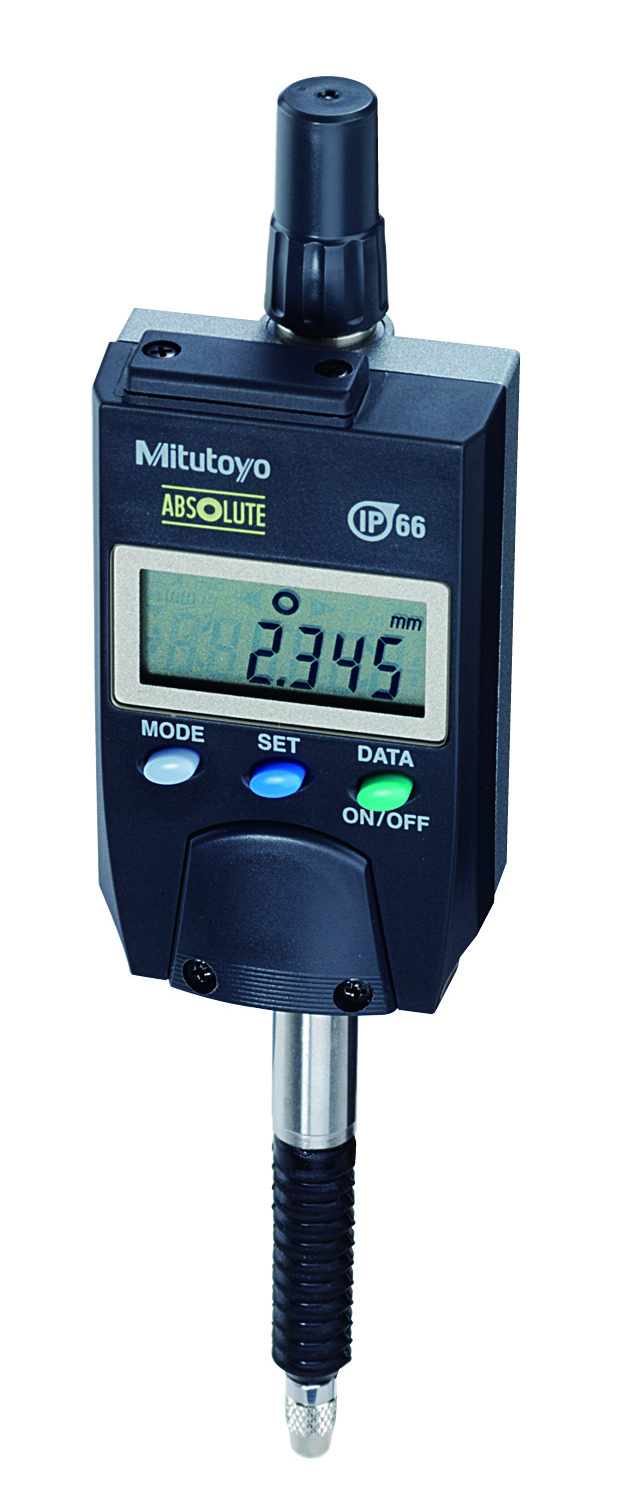

ABSOLUTE Digimatic Indicator ID-N
The Mitutoyo ABSOLUTE Digimatic ID-N series indicator is ideal for accurately measuring short, linear distances in tight spaces and harsh workshop conditions. Measurements are shown on a rotatable LCD display.
The Mitutoyo ABS ID-N Series digital indicator features a slim body that rotates up to 180 degrees for taking measurements from different directions. The 35mm-wide body provides measurements in tight, restricted spaces where standard gage graduations are difficult to read. The ID-N indicator measures linear distances up to 5mm (metric only) or 12.7mm/.5” (Inch/Metric model), and some models have a selectable resolution and accuracy of up to +/-0.003mm/.00012”.
  • Signal can be outputted to an external device; waterproof data output connector protects against dust, water and oil ingress
  • Functions include: Zero-setting, presetting, direction switching, tolerance judgment, display hold, data output, resolution switching, and inch/mm conversion (on inch/metric models only)
  • Sealed housing meets IP66 rating for improved protection against water, dust, oil and water jets
SERIES 543 Technical Data
Technology: Digimatic
IP Rating: IP66
SPC Output: Yes
Max Response Speed: Unlimited
Battery: SR44 (1 pc.) 938882
Battery life: Approx. 7000 hours under normal use
Order No.: Product Image: Units: Min Range: Max Range: Resolution: Selectable resolution: Accuracy: Stem diameter: Thread type: Optional Accessories: ANSI/AGD type: ISO/JIS type:
543-570 - Metric 0mm 5mm 0.01mm - ±0.02mm 8mm M2.5 X 0.45 - - Yes
543-571 Metric, Inch 0" / 0mm .5" / 12.7mm 0.0005" / 0.01mm - ±.0008" / ±0.02mm 3/8" 4-48 UNF - Yes -
543-575 Metric 0mm 5mm 0.001, 0.01mm Yes ±0.003mm 8mm M2.5 X 0.45 - - Yes
543-576 Metric, Inch 0" / 0mm .5" / 12.7mm .0005, .00005" / 0.001, 0.01mm Yes ±.00012" / ±0.003mm 3/8" 4-48 UNF - Yes -
