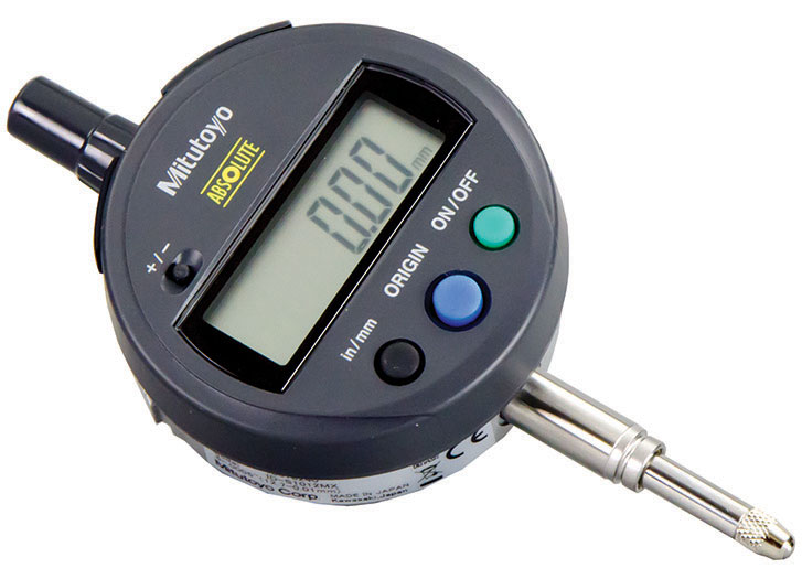

ABSOLUTE Digimatic Indicator ID-S
The Mitutoyo ABSOLUTE Digimatic ID-S indicators are highly accurate and easy to use for measuring short linear distances in many different applications. Measurements are shown on an impact-resistant LCD display.
The Mitutoyo ABS digital ID-S digital indicators provide up to a 12.7mm / .5" range in a compact design that is easy to use and read. Large push buttons provide direct, easy access to all of the indictor’s functions, and readings are shown on a large 9mm LCD display. The ABSOLUTE sensor automatically restores the last origin position when the indicator is turned on, allowing for quick-start operation which is useful in multipoint measurements.
  • Similar in size to standard Series 2 dial indicators
  • Available with or without SPC output capabilities
  • Functions include Origin set, zero set, counting direction switching, power On/Off, data output and inch/mm conversion (on inch/metric models only)
  • Alarm: Low voltage, counting value composition error, over-flow error
  • IP42 for protection against objects greater than 1mm and water
Technology: Digimatic
SPC Output: Yes
Battery: SR44 (1 pc.) 938882
Battery life: Approx. 20,000 hours under normal use
Max Response Speed: Unlimited
