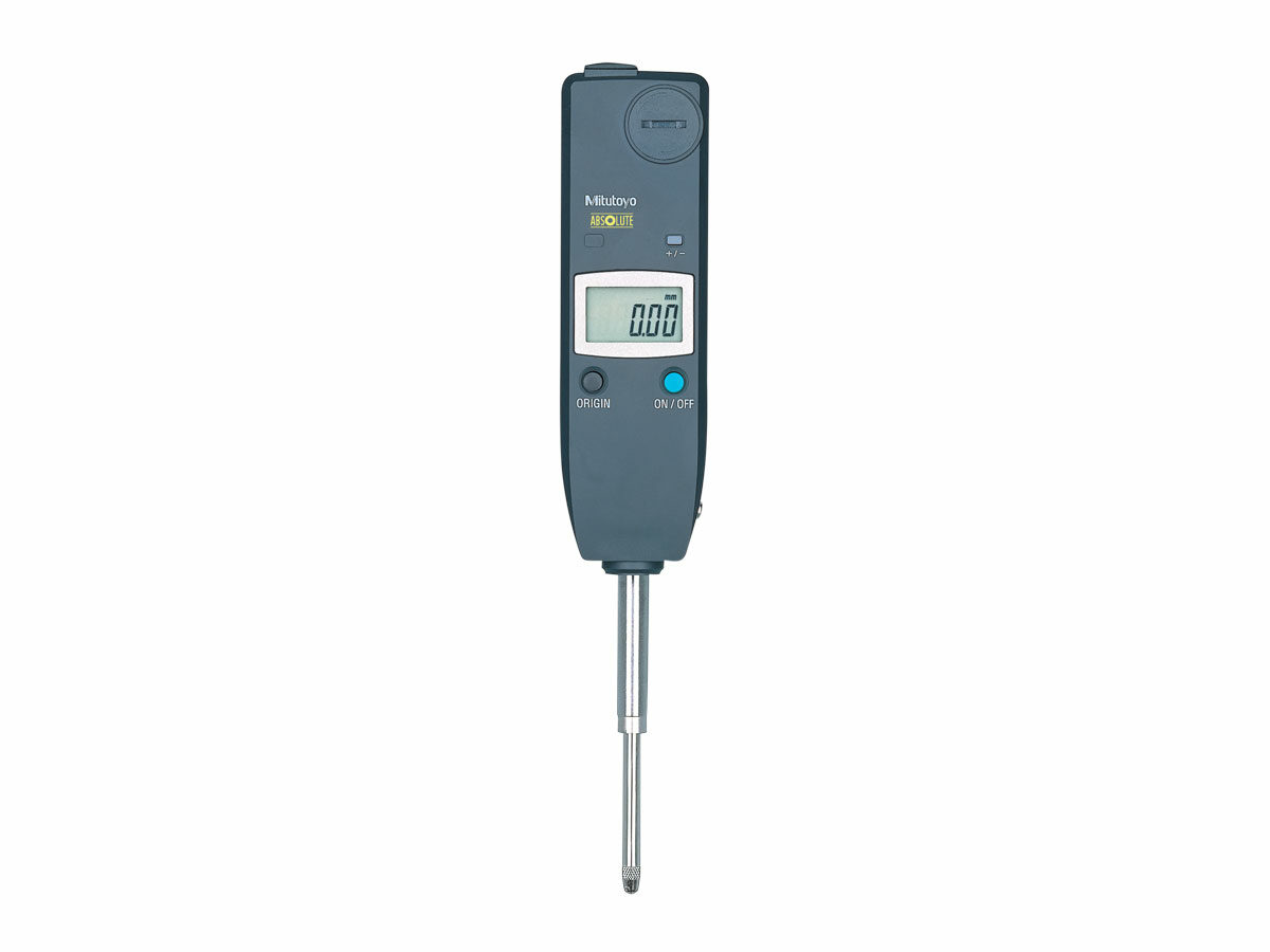

ABSOLUTE Digimatic indicator ID-U
The Mitutoyo ABSOLUTE Digimatic ID-U slim-design indicators are highly accurate, easy to use and suitable for installation into measuring devices for measuring short linear distances. Measurements are shown on an impact-resistant LCD display.
View Dimensions

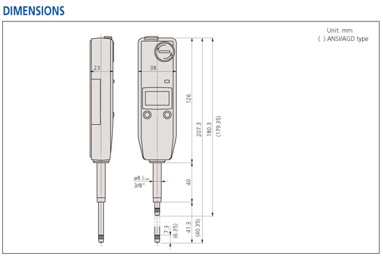

The Mitutoyo ABS digital ID-U digital indicators with a slim, simple design provide up to a 25.4mm/1” range that is easy to use and read. Large push buttons provide direct, easy access to all of the indictor’s functions, and readings are shown on a large 8mm LCD display. The ABSOLUTE sensor automatically restores the last origin position when the indicator is turned on, allowing for quick-start operation which is useful in multipoint measurements. The indicator’s 23mm depth and approximately 20,000 hour battery life makes it suitable for installing in measuring devices.
  • Available with or without SPC output capabilities
  • Functions include Origin set, zero set, counting direction switching, power On/Off, data output and inch/mm conversion (on inch/metric models only)
  • Alarm: Low voltage, counting value composition error, over-flow error
