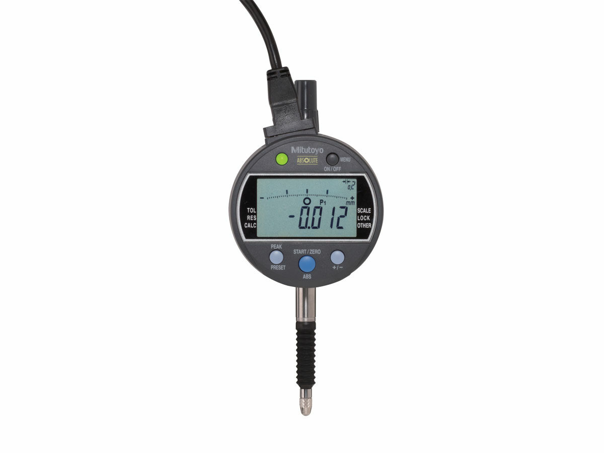

The Mitutoyo ABSOLUTE Digimatic ID-C indicators with signal output function uses a green/red LED and Go/No-Go output to quickly show if measurements are within tolerance. Measurements are shown on a large, easy-to-read LCD display.
The Mitutoyo ABS ID-C signal output digital indicator has a maximum/minimum value holding function to perform Go/No-Go judgements against the peak values set. The judgement is performed by calculating the measurement data obtained instead of through a mechanical or electrical contact which provides better reliability. The judgement is indicated by green and red LEDs and “<, O, >” signs on the LCD allowing the signal to be outputted to an external device such as a sequencer through the NPN open-collector.
  • The high-speed detector measures 100 times per second
  • Signal can be outputted to an external device
  • Analog bar provides easy-to-read values when scanning for Max, Min and TIR values
  • Go/No-Go judgements are performed by setting the upper and lower tolerances
  • Functions include Data output, remote control, origin set, zero-set, Go/No-Go judgement, analog bar, fast measuring frequency, peak detection, calculation, counting direction switching, power On/Off, data output and inch/mm conversion (on inch/metric models only)
  • IP54 for protection resists dust and contaminants from machine shop environments
