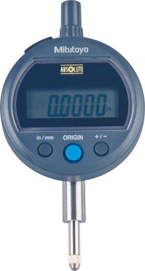

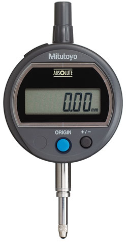

The Mitutoyo ABSOLUTE Digimatic solar powered indicators are highly accurate
ABSOLUTE Solar Digimatic Indicator ID-S

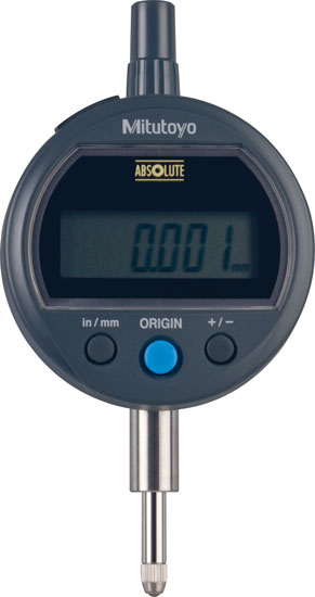

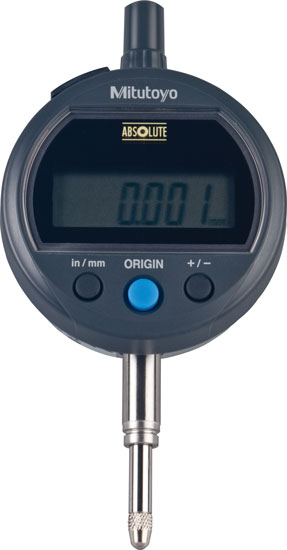

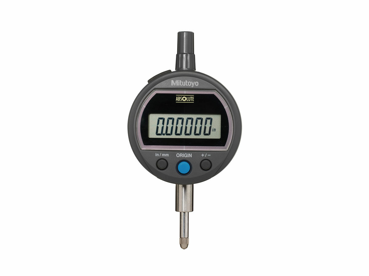

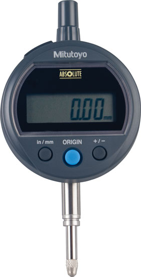

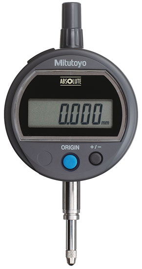

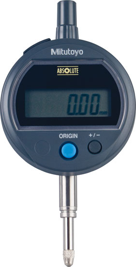

The Mitutoyo ABSOLUTE Digimatic solar powered indicators are highly accurate and easy to use while eliminating the need of a battery. Measurements are shown on an impact-resistant LCD display.
The Mitutoyo ABS digital ID-S digital indicators provide up to a 12.7mm/.5” range in a compact design that is easy to use and read. Large push buttons provide direct, easy access to all of the indictor’s functions, and readings are shown on a large 9mm LCD display. The ABSOLUTE sensor automatically restores the last origin position when the indicator is turned on, allowing for quick-start operation which is useful in multipoint measurements. The solar power source is ready for use from 40 lux illumination and a super capacitor maintains a reserve of about 3.5 hours under low light conditions.
  • Similar in size to standard Series 2 dial indicators
  • Available with or without SPC output capabilities
  • Solar power and battery backup allows for reliable, longer use in any location
  • Solar panel is hard-coated for increased durability
  • SPC output function allows for fast and easy data management in real time
  • Functions include Origin Set, Counting Direction Switching and inch/mm conversion (on inch/metric models only)
  • IP42 for protection against objects greater than 1mm and water
