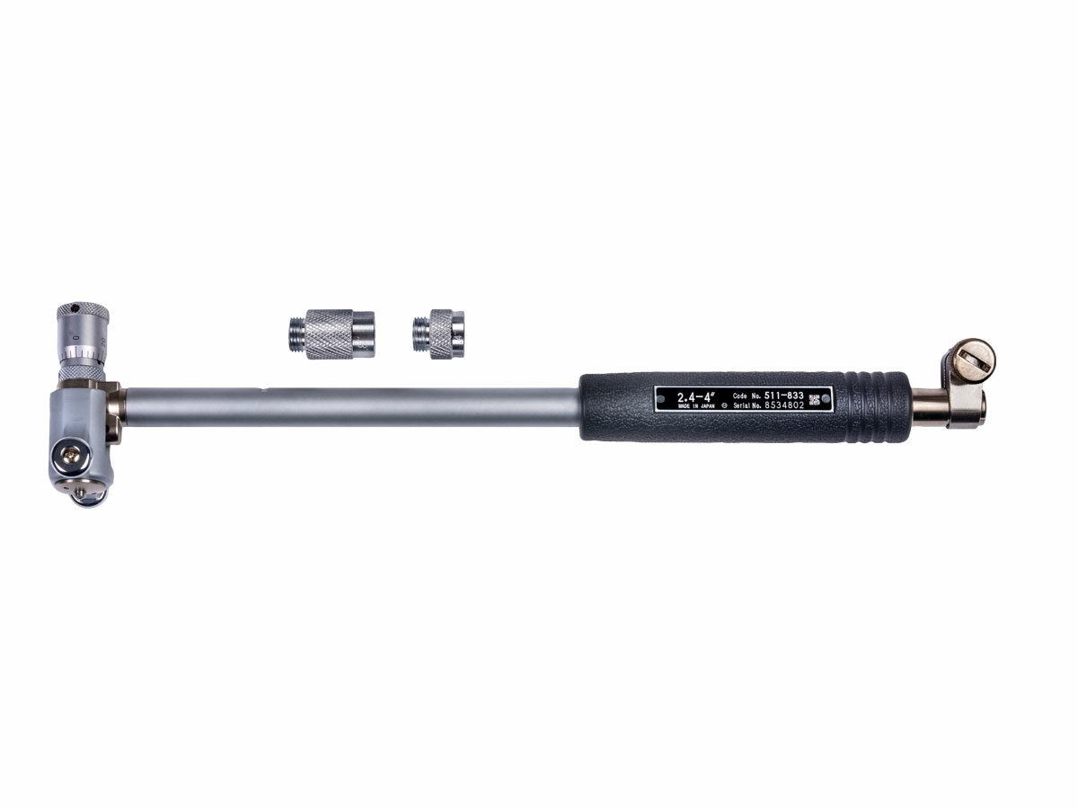

The Mitutoyo bore gage with micrometer head and interchangeable anvils greatly expand the gage’s measurement range with high accuracy.
The Mitutoyo bore gage with micrometer head delivers a wide range of bore measurement capabilities at high accuracy to 2µm. Interchangeable anvils constructed of alloy steel attach to the micrometer head for accurate dimensional setting. The anvils feature a carbide-tipped ball for better measurement reliability and longevity.
- Does not include a Mitutoyo Dial Indicator
- Available in Inch models
- Inch models have a graduation option of .0005” and .0001”
- Optional extension rods are available to measure deeper bores and holes
- Large, newly designed hollow grips are easier to hold and reduce heat transfer from the operator for better accuracy
- Gage stem diameter is .375”
