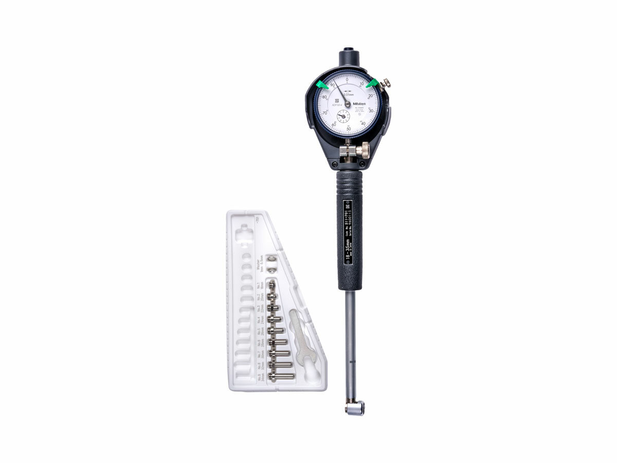

The Mitutoyo standard type bore gages feature interchangeable anvils and spacers to take highly accurate diameter measurements of a wide range of bore hole sizes.
Series 511
Bore Gage-Standard-8mm with Indicator
The Mitutoyo standard type bore gage is available in measuring ranges from 18mm-150mm to measure inside bore diameters with accuracy to 2µm. The bore gage comes with interchangeable anvils to measure different bore diameters with the same gage. A pendulum guide structure improves the slide of the gage for measurements while a two-point contact system detects geometry anomalies such as ovalness and taper.
- Includes a Mitutoyo Dial Indicator
- Available in Metric models
- Optional extension rods are available to measuring deep hole with accuracy
- Large, newly designed grips are easier to hold and reduce heat transfer from the operator for better accuracy
- Gage stem diameter is 8mm
SERIES 511 Technical Data
| Technology: | Mechanical |
| Units: | Metric |
| Accuracy: | +/-2µm |
| Repeatability: | 0.5µm |
| Adjacent Error: | 1µm |
| Stem Diameter: | 8mm |
