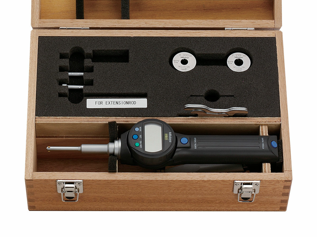

The Mitutoyo Borematic ABS Digimatic snap-open bore gage interchangeable set includes a gage display unit and measuring heads for each size in the set. This bore gage set delivers a wide range of accurate internal dimension measurements output that is cost efficient.
The Mitutoyo Borematic snap-on bore gage interchangeable set includes a display unit and interchangeable measuring heads for each available size in the set. The Borematic bore gage features a large LCD display that rotates 330° for easy reading and an activation handle with a precision-balanced spring that smoothly retracts the anvils when pressed. Titanium Nitride (TiN) coated measuring contact points provide excellent durability and impact resistance and allow the instrument to measure to the bottom of a blind hole. With the ABSOLUTE encoder, once the origin point is set with the ORIGIN button, the Borematic retains the setting for the entire battery life. Repeated origin setting (presetting) is no longer necessary.
- Available in Metric and Metric/Inch sets
- Metric sets include heads with measuring ranges from 6-12mm to 75-100mm
- Metric/Inch sets include heads with measuring ranges from 6.925-12.7mm / .275-.5″ to 76.2-101.6mm / 3-4″
- Optional extension rod allows for measuring deep holes
- Optional setting rings for zero point adjustment are available
- Contact points are constructed of TiN for impact resistance and better durability
- Design allows for measurements closer to the bottom of blind bore holes
- ABSOLUTE (ABS) linear scale eliminates the need for setting the origin point every time the micrometer is powered on
- Elimination of overspeed errors provides a higher measurement reliability and repeatability
- Functions include Zero/ABS Setting, GO/NO-GO judgment, power On/Off, and inch/mm conversion (on inch/metric models only)
- Supplied in fitted wooden case
