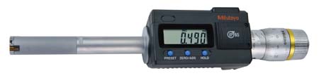

Digimatic Holtest-Three-Point Internal

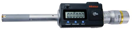

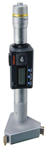

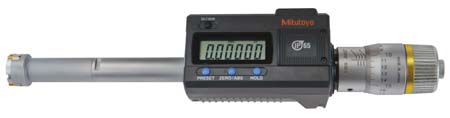

The Mitutoyo Digimatic Holtest internal micrometer utilizes three anvils and contact points for self-centering, precision measurements of the inside dimensions of bores.
The Mitutoyo Digimatic Holtest digital internal micrometer features self-centering anvils evenly spaced at 120° with contact points coated in Titanium Nitride (TiN) to provide accurate, sensitive measurements that are highly durable. Precision-machined gears ensure reliable, repeatable measurements that are shown on a large, easy-to-read LCD display in an impact and water resistant housing. The holtest’s ratchet stop mechanism provides a constant measuring force on the hardened-steel spindle to ensure accurate, even measurements.

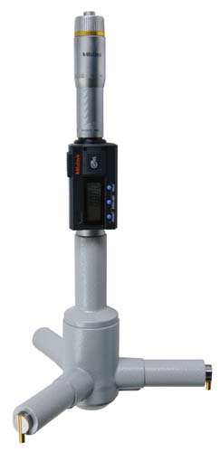

  • Optional extension rod allows for measuring deep holes
  • Functions include Zero/ABS Setting, Data Hold, Data Output, Function Lock, 2 Presets, and inch/mm conversion (on inch/metric models only)
  • Alarm: Low Voltage, Counting Value Composition Error, Battery Replacement
  • Scale on thimble and sleeve is laser etched for easier reading in all conditions
  • IP65 protection permits use in environments exposed to cutting oil, dust, etc.*

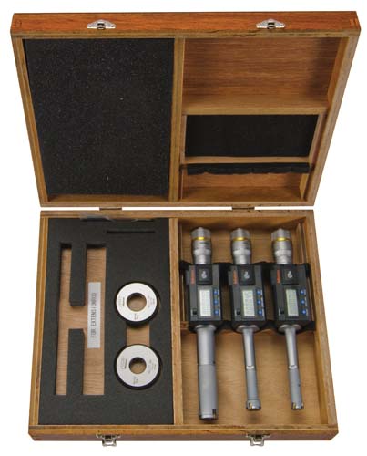

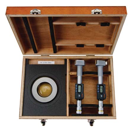

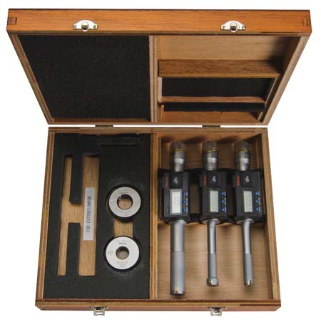

  • Holtests up to 100mm/4” diameter measurements supplied in a fitted plastic case
  • Holtests over 100mm/4” diameter measurements supplied in a wooden case
*Anti-corrosion treatment is required after use
SERIES 468 Technical Data
Technology: Digimatic
Contact Point: TiN coating
Measuring Method: Three-point method
Battery: SR44 (2 pcs.) 938882
Battery Life: Approx. 1.2 years under normal use
Ratchet/Thimble: Ratchet Stop
IP Rating: IP65
SPC Output: Yes

468-981 - Metric 6 - 12mm 0.001mm ±2µm - 10 - 10-12mm - -
468-982 Metric 12 - 25mm 0.001mm ±3µm - 20 - 20-25mm - -
468-983 Metric 25 - 50mm 0.001mm ±3µm - 30 - 40-50mm - -
468-984 Metric 50 - 75mm 0.001mm ±4µm - 62 - 62-75mm - -
468-985 - Metric 75 - 100mm 0.001mm ±4µm - 87 - 87-100mm - -
468-986 - Inch 6.925 - 12.7mm / 0.275-0.5" 0.001mm / 0.00005" ±2µm / ±0.0001" - .425 - .425-.5" - -
468-987 Inch 12.7 - 25.4mm / 0.5-1" 0.001mm / 0.00005" ±3µm / ±0.00015" - .8 - .8-1" - -
468-988 Inch 25.4 - 50.8mm / 1-2" 0.001mm / 0.00005" ±3µm / ±0.00015" - 1.2 - 1.6-2" - -
468-989 Inch 50.8 - 76.2mm / 2-3" 0.001mm / 0.00005" ±4µm / ±0.0002" - 2.5 - 2.5-3" - -
468-990 - Inch 76.2 - 101.6mm / 3-4" 0.001mm / 0.00005" ±4µm / ±0.0002" - 3.5 - 3.5-4" - -
