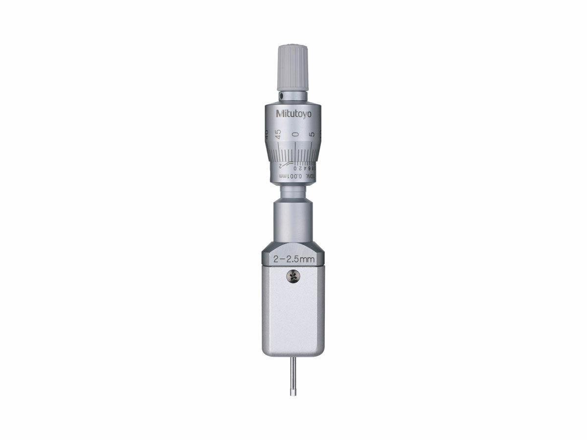

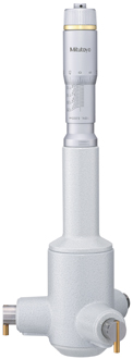

Mechanical Holtest Three-Point/Two-Point Internal Micrometers
The Mitutoyo Holtest mechanical three-point internal micrometer utilizes three self-centering anvils with precision contact points for accurate and efficient measurements of inside dimensions of bores.
The Mitutoyo mechanical Holtest internal micrometer features three hardened-steel anvils evenly spaced at 120° for true alignment of the axis bore for accurate, easily repeatable measurements. Contact points are coated with Titanium Nitride (TiN)* for added durability and precision. The holtest’s ratchet stop mechanism provides a constant measuring force on the hardened-steel spindle to ensure accurate, even measurements.
  • Optional extension rod allows for measuring deep holes
  • Optional setting rings for zero point adjustment are available
  • Scale on thimble and sleeve is laser etched for easier reading in all conditions
  • Holtests up to 100mm / 4″ diameter measurements supplied in a fitted plastic case
  • Holtests over 100mm / 4″ diameter measurements supplied in a wooden case
* Models under 5-6mm / .24-.28″ are carbide

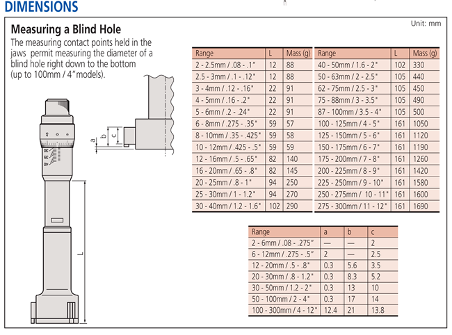

SERIES 368 Technical Data
Technology: Mechanical
Ratchet/Thimble: Ratchet Stop
Order No.: Product Image: Units: Range: Graduation: Accuracy: Mass: Contact Point: Measuring Method: Extension Rod (Optional):
