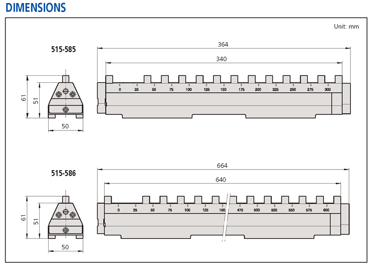

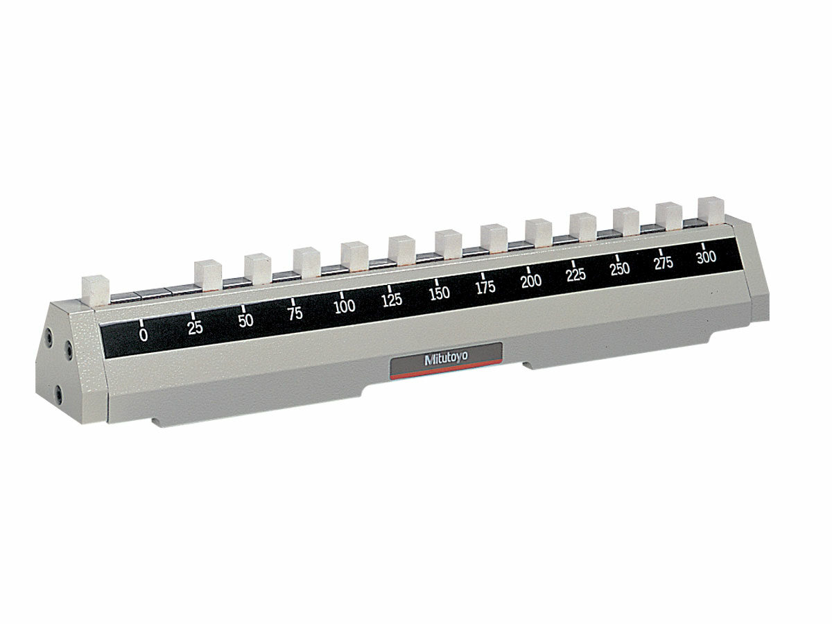

Inside Micro Checker
The Mitutoyo inside micro checker effectively checks the zero point of tubular inside micrometers to ensure continuous accurate measurements.
View Dimensions
The Mitutoyo inside micro checker confirms the zero point of a tubular inside micrometer in order to provide repeatable reliable measurement results. The micro checker’s measuring blocks are constructed of highly durable zirconia-based ceramic that will not deteriorate or change dimensionally over time due to environmental conditions. The inside micro checker confirms measurements in 25mm increments.
  • Available in two ranges: 300mm and 600mm
  • Includes: 10mm auxiliary block, clamping element with V-rest and spacer for 8mm diameter measuring anvil
  • Measuring blocks are constructed of zirconia-based ceramics for better durability
  • The wooden case is an optional accessory
SERIES 515 Technical Data
Technology: Mechanical
Units: Metric
Block pitch accuracy: 1+L/150
Order No.: Product Image: Range: Length to check: Accessories:
515-585 12 - 300mm 25, 50, 75, 100, 125, 150, 175, 200, 225, 250, 275, 300 -
515-586 - 12 - 600mm 25, 50, 75, 100, 125, 150, 175, 200, 225, 250, 275, 300, 325, 350, 375, 400, 425, 450, 475, 500, 525, 550, 575, 600 -
