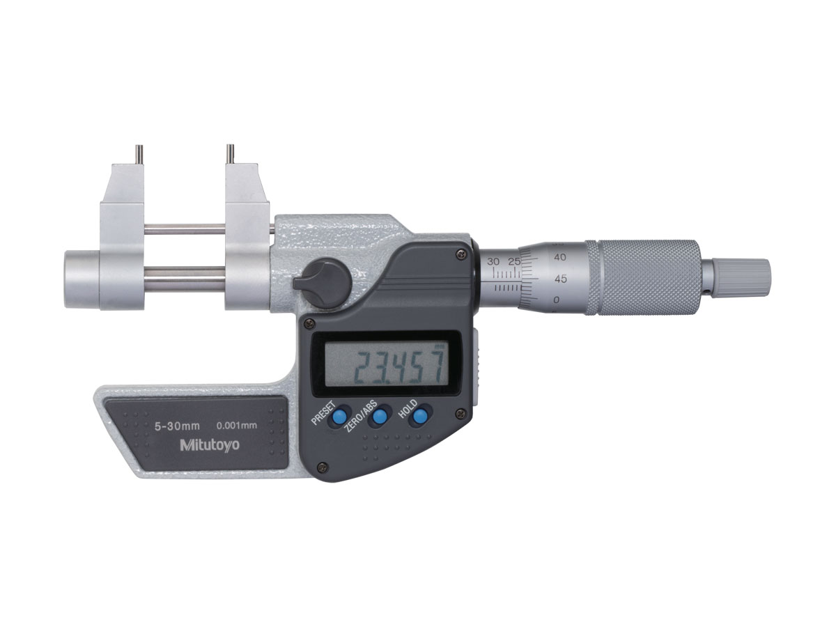

The Mitutoyo digital caliper-type inside micrometer provides the ability to measure inside dimensions with high accuracy and precision. Its caliper-type jaws are constructed of hardened  steel for lasting durability and accuracy. A clamp locks the spindle for easier manual measurement readings. Measurements are displayed on an easy-to-read LCD readout.
  • Available in Metric and Metric/Inch models
  • Optional setting rings for zero point adjustment are available
  • A special holder is available to use with a Mitutoyo micrometer stand
  • SPC output function offers quick and easy data management in real time
  • Functions include Origin Setting, Zero Setting, Function Lock, 2 Presets, Data Hold, Data Output, and inch/mm conversion (on inch/metric models only)
  • Frame has a low-glare satin-chrome and non-slip grip finish
  • Supplied in fitted plastic case; models over 175mm / 4″ supplied in wooden case

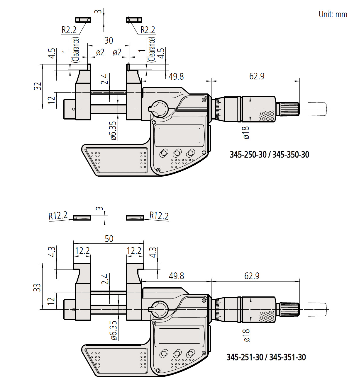

SERIES 345 Technical Data
Technology: Digimatic
Measuring Faces: Caliper Type
Battery: SR44 (1 pc.) 938882
SPC Output: Yes
Graduation: 0.01mm / 0.001"
Order No.: Product Image: Units: Range: Resolution: Accuracy: Jaw Type: Accessories:
345-250-30 Metric 5 - 30mm 0.001mm ±5µm Pin -

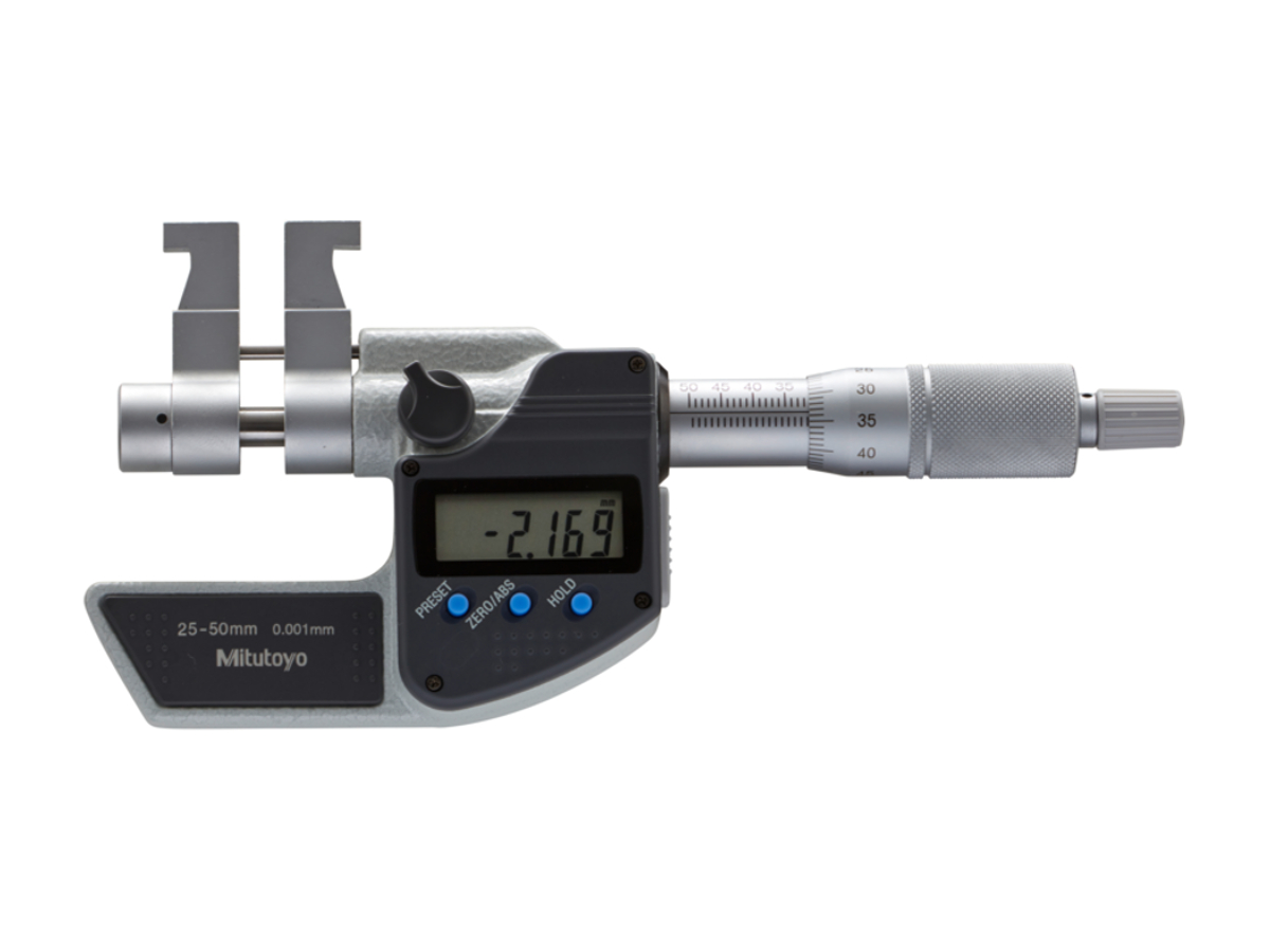

345-251-30 - Metric 25 - 50mm 0.001mm ±6µm Anvil -

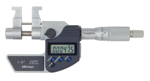

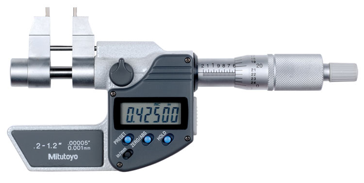

345-350-30 Metric, Inch 5 - 30mm / 0.2-1.2" 0.001mm / 0.00005" ±0.00025" Pin -
345-351-30 Metric, Inch 25 - 50mm / 1-2" 0.001mm / 0.00005" ±0.0003" Anvil -
