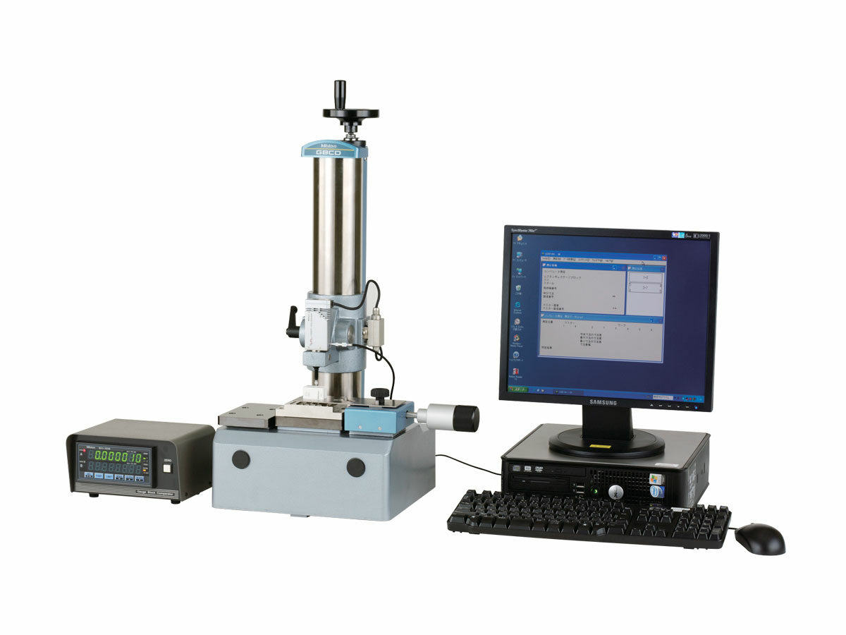

The Mitutoyo manual gage block comparator features dual gage heads to easily compare gage blocks to the comparator’s standard gage block.
Series 565
Manual Gage Block Comparator
The Mitutoyo manual gage block comparator uses dual gage heads to easily compare gage blocks between 0.1mm/.004” and 250mm/10” with the standard gage block on the GBCD-250 manual gage block comparator. The differential dual gaging heads assure the operator of a high-accuracy measurement which is easy to use.
- Available in Inch/Metric
- Measuring units are laser hologage (upper and lower)
- SPC output function allows for quick and easy data management in real time with optional data cable
- Automatic comparator GBCD-100A is also available
| Order No.: | Product Image: | Range: | Resolution: | Accuracy: | Measuring Unit: | Temperature Operation: | Operating Humidity Condition: | Data output: | Main Unit Dimensions: | Display Unit Dimensions: | Main Unit Mass: | Display Unit Mass: | Optional Accessories: |
| 565-151A | - | .004 - 10" / 0.1 - 250mm | .0000001" / 0.000001mm | ±0.03+0.3L/1000µm | Laser hologage | 20 +/-1° C | 30% RH to 60% RH | SPC | 455 x 318 x 691mm | 345 x 397 x 187mm | Approx. 52kg | Approx 9kg | - |
