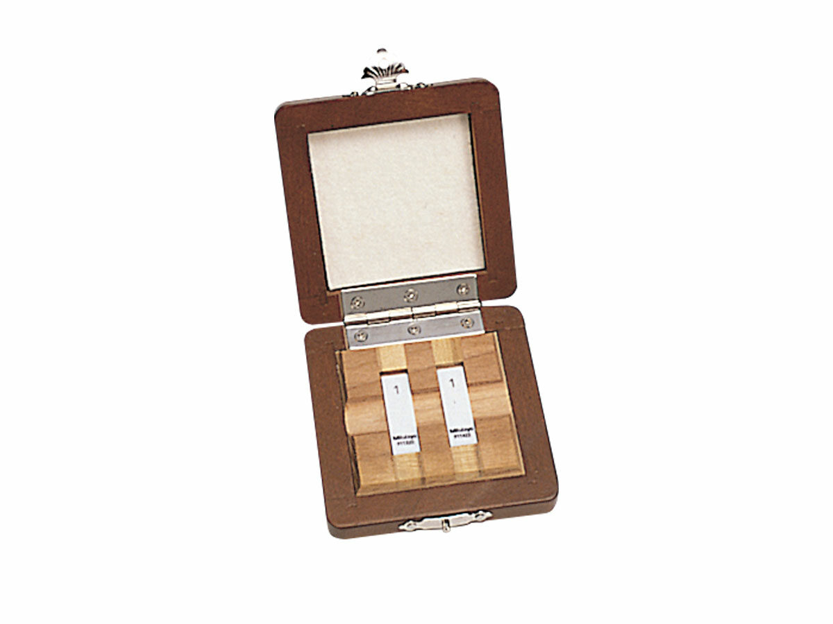

The Mitutoyo metric rectangular wear gage block sets are designed to be used on the ends of stacked gage block sets to prevent wear.
Series 516
Metric Rectangular Gage Block Set – Wear Block
The Mitutoyo Metric Rectangular Wear Gage Block Sets are available in different grades and sizes, ideal for protecting steel or CERA gage block rung stacks from wear. Constructed with either ceramic or carbide materials, gage wear block sets provide better wear resistance and longer shelf life, protecting the accuracy of often-used gage block sets.
- Available in CERA and carbide block sets
- CERA blocks are free from dimensional change over time; have 10 times the abrasion resistance of steel gage blocks
- Black characters on gage blocks are inscribed by laser and clearly visible
- Provided with Inspection Certificate
