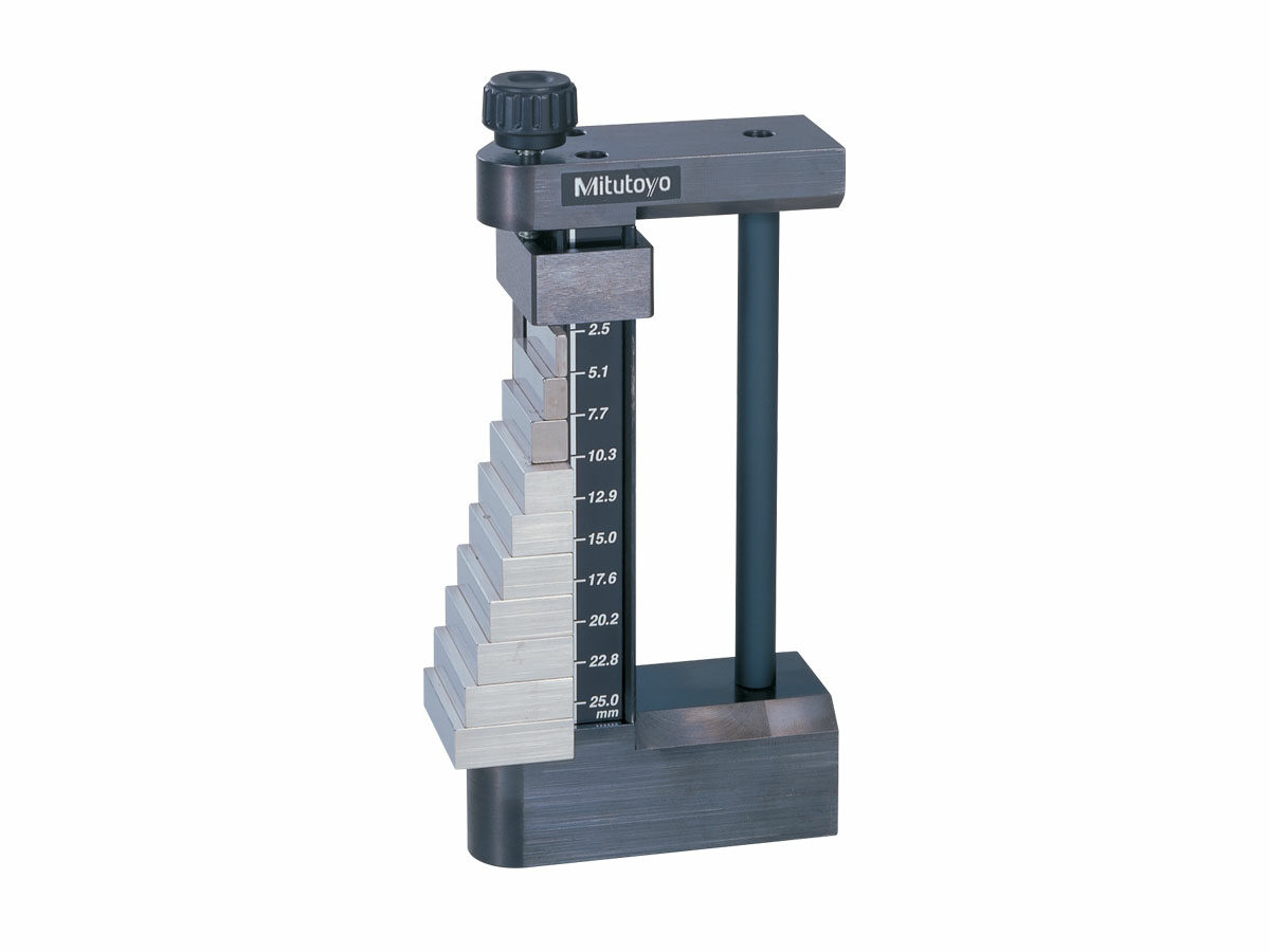

The Mitutoyo Micro Checker holds and safely clamps final gage block stacks in place for accurate inspections.
Series 516
Micrometer Inspection Gage Block Holder
The Mitutoyo Micro Checker creates a stable platform to stack a series of gage blocks in place for accurate, repeatable inspections for many different types and sizes of micrometers. The Micro Checker’s clamp is operated with an easy-to-use thumb screw.
- Available for Metric and Metric/Inch gage block sets
- Gage blocks and gage block sets are not included with the Micro Checker
- Sturdy base and solid gage block clamp provide stable inspection platform
