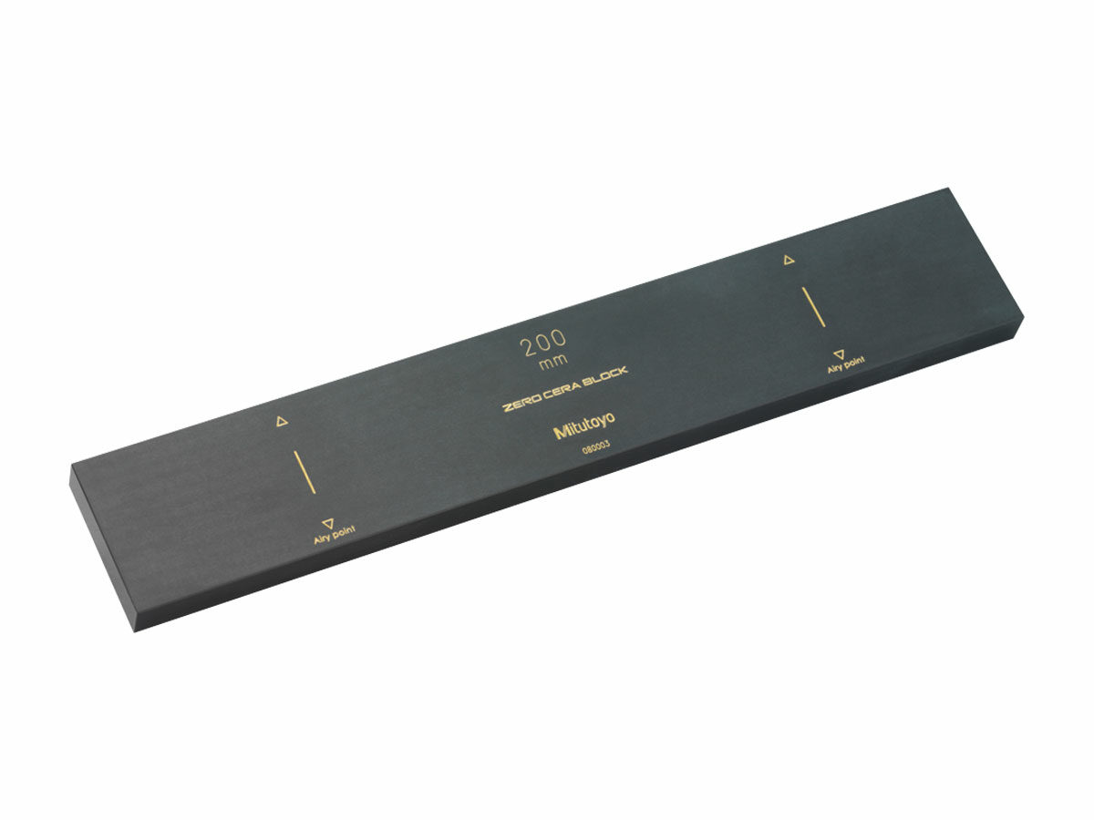

The Mitutoyo rectangular Zero CERA gage blocks experience almost no secular change both in dimension and coefficient of thermal expansion for exceptionally accurate results.
The Mitutoyo rectangular Zero CERA gage blocks have a thermal expansion coefficient 1/500th that of steel at 20±1°C for unmatched, exact precision. There is almost no secular change in dimension and coefficient of thermal expansion. The Zero CERA blocks are available in nominal sizes from 30mm-1000mm and have an ultra-low thermal expansion and high specific gravity (Young’s Modulus/specific gravity).
- Available in Metric blocks only
- Zero CERA blocks are sold individually or in a set
- Thermal expansion in the temperature range 20±1°C less than 1/500 that of steel (0±0.02×10¯⁶/K(20°C))
- CERA blocks are free from dimensional change over time; have 10 times the abrasion resistance of steel gage blocks
