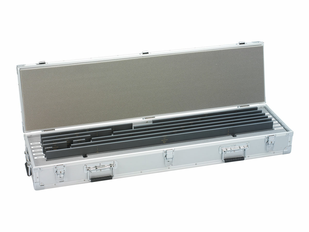

Mitutoyo Zero CERA blocks are an innovative length standard offering ultra low thermal expansion and excellent long-term stability.
Mitutoyo CERA blocks are made of ultra-low expansion ceramic with a thermal expansion 1/500 that of steel in a temperature range of 20±1°. The magnetization-free and magnetization-free CERA gage blocks help improve calibration work efficiency by eliminating the need for temperature compensation and provide excellent long-term stability with 50% better rigidity and flexural strength of glass 1/3 specific gravity of steel.
- Suitable for calibrating the temperature compensation of machine tools and measuring instruments in a non-20°C environment
- Almost no stability change in both dimension and coefficient of thermal expansion
- Lightweight with high rigidity and flexural strength
- CERA blocks will not rust or magnetize
