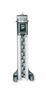

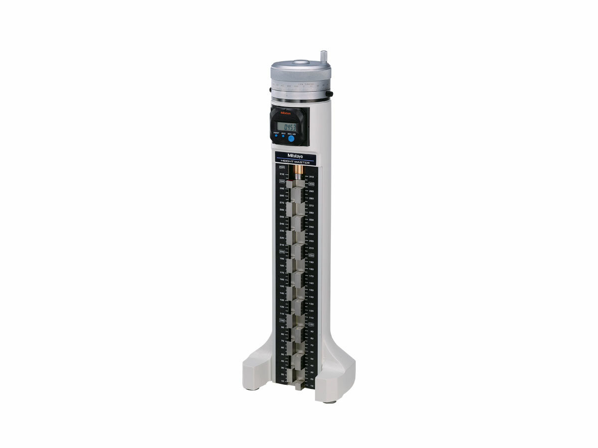

The Mitutoyo Digital Height Master uses a set of staggered 20mm/1” moveable gage blocks within the housing to provide reference calibration for height gages and bore gages. Measurements are displayed on a LCD screen.
Series 515
The Mitutoyo Digital Height Master features a digital micrometer head with fine adjustment capabilities for height setting, providing highly accurate height and bore gage calibration reference. The reference blocks may be stacked straight or staggered to expose both the top and bottom measuring faces depending on the application. The final confirmation measurement is the sum of the measuring block position, the counter value and the micrometer head reading. The Digital Height Master features a digital display with all essential specifications required for versatile height standards.
- Available in Metric and Inch/Metric
- Staggered block step: 20mm/1”
- SPC output function allows for quick and easy data management in real time with optional data cable
- Functions include zero-setting, presetting, ABS/INC switching, data hold, data output, inch/mm conversion (on inch/metric models only)
- Alarms include low voltage and counting value composition error
- Counter tracks the number of micrometer head turns
- Each height master is supplied with a gage block for zero setting
- Cast iron housing provides stable height measurement and long service life
- Three carbide-tipped pads lapped for accurate reference and durability
- Includes Certificate of Inspection
- Supplied in a fitted wooden case
