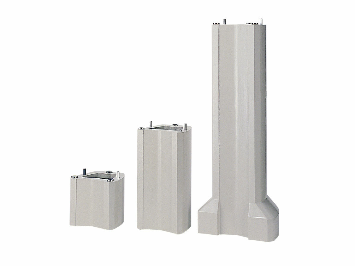

The Mitutoyo riser blocks are specifically designed to increase the range of Mitutoyo manual and digital height masters.
The Mitutoyo riser blocks are constructed with the same exacting standards as our height masters. Available in three different height extensions in metric or inch units, these riser blocks extend the height calibration ranges of Mitutoyo height master units. Specially designed pins on the top of the riser blocks ensure secure mating with the height masters for stable, accurate height measurements and comparisons.
  • Available in Metric and Inch/Metric
  • Metric riser block heights include: 150mm, 300mm and 600mm
  • Inch riser block heights include: 6”, 12” and 24”
  • Cast iron housing provides stable height measurement and long service life
Order No.: Product Image: Units: Accuracy: Mass:
515-113 - Metric ±0.6µm 5.7kg
515-114 - Metric ±1µm 11.3kg
515-115 - Metric ±2µm 31kg
515-116 Inch 20µin 5.7kg
515-117 Inch 40µin 11.3kg
515-118 Inch 80µin 31kg
