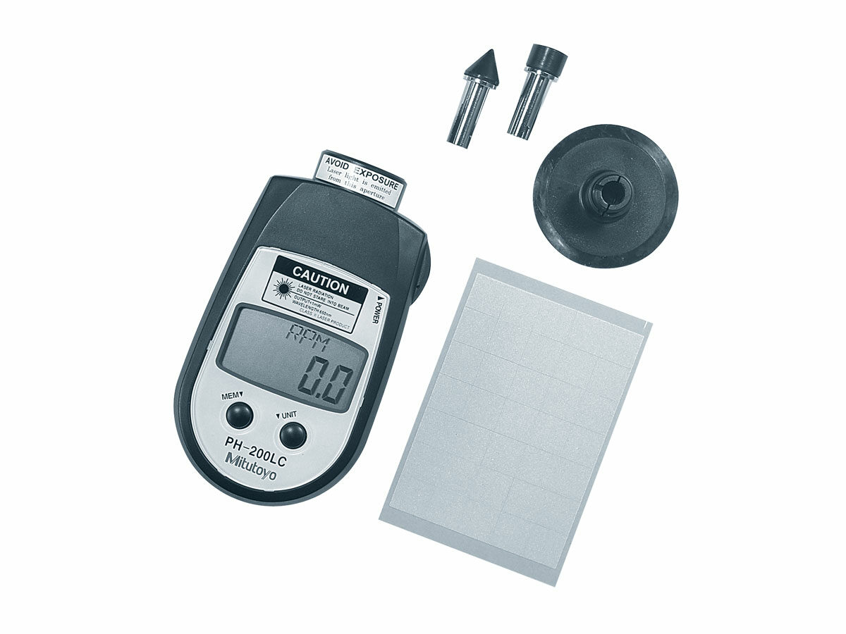

The Mitutoyo Digital Hand Tachometers digitally measure the revolutions of rotating objects, providing accurate measurements on a large, easy-to-read LCD display. These hand tachometers are ergonomic to hold and simple to use with operational buttons carefully placed for quick finger or thumb presses.
  • Model PH-100A uses a 20-pulse per revolution optical coupler for measurement
  • Model PH-200LC uses a laser diode, contact/no-contact combination for measurement
  • Calibration is simple, requires no special fixtures or tools
  • Powered by 3 AAA batteries
  • Includes NIST certification

Order No.: Product Image: Model: Revolutions Per Minute: Rotation Speed (Non-Contact): Rotation Speed (Contact): Measurement Accuracy: Detection: Outside Dimensions HxWxD: Mass:
982-551 PH-100A 1.0 - 25,000 - - 1.0 - 599.9rpm: ±1rpm, 600.0 - 25,000 rpm Optical coupler, 20 pulses per revolution 4.83 L: x 2.52 W x 1.24 H" / 122.5 x 64 x 31.5mm 170g
982-552 PH-200LC - 6.0 - 99,999 rpm 6.0 - 25,000 rpm 6.0 - 599.9rpm: ±1rpm, 600.0 - 99,999 rpm Laser diode 4.55 L: x 2.52 W x 1.24 H" / Overall length with contact adapter: 149mm 160g
