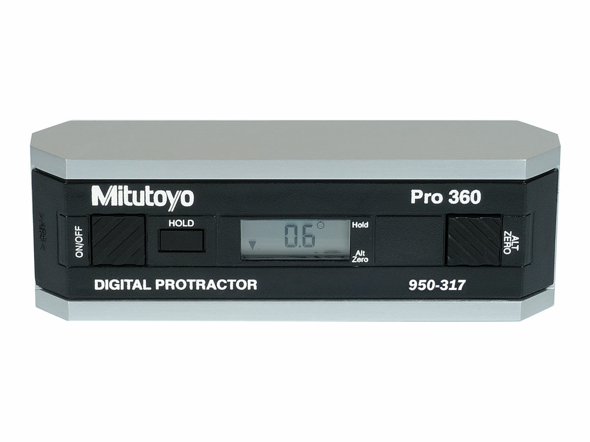

The Mitutoyo Digital Protractor Pro 360 and 3600 uses an electronic gravity sensor powered by the latest low-power electronic circuit technology to make incline measurements on flat surfaces. Visit Mitutoyo.com to learn how to use a digital protractor.
Digital Protractor
The Mitutoyo Digital Protractor Pro Series present inclination values on an easy-to-read digital LCD display.

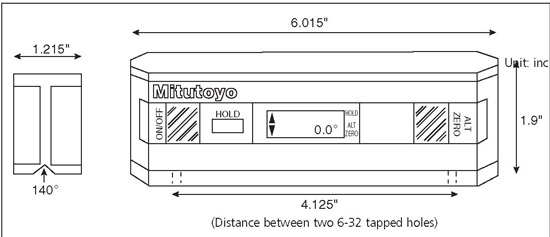

View Dimensions
The Mitutoyo Digital Protractor Pro 360 and 3600 uses an electronic gravity sensor powered by the latest low-power electronic circuit technology to make incline measurements on flat surfaces. The Digital Protractor Pro has a full 360° measuring range, and the LCD display remains upright to view at all angles for easy, accurate readings on the Pro 360 model. The Pro 3600 utilizes RS-232 output for digital data management.
  • Digital Protractor Pro 3600 has SPC output function for fast and easy data management in real time with optional data cable
  • Calibration is simple and requires no special fixtures or tools
  • Frame is constructed of machined aluminum for lightweight portability and durability
  • Powered by 9V battery for 500 hour battery life
