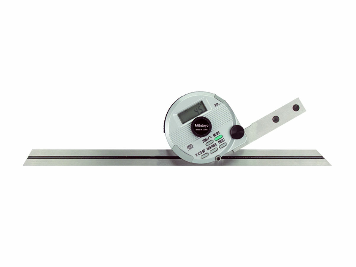

The Mitutoyo Digital Universal Protractor measures angles in both clockwise and counterclockwise directions to accurately position a workpiece or to repeat specific angle cuts.
The Mitutoyo Digital Universal Protractor uses an electronic gravity sensor to generate and process highly accurate inclination values on an easy-to-read LCD screen in degrees and minutes. The protractor has a 360-degree measuring range in clockwise and counterclockwise directions to quickly measure angles for repeatable angle cuts or workpiece positioning.
  • Fine-setting function provides high precision with resolution to 1 minute of arc and accuracy
  • Protractor can be attached to a Height Gage
  • Body is constructed of stainless steel for durability and corrosion resistance
  • Functions include zero-set, direction selection, data output, data hold, preset, switchable seagesimal or decimal notation
  • Alarms include low battery voltage and over speed error
  • Blade is removable

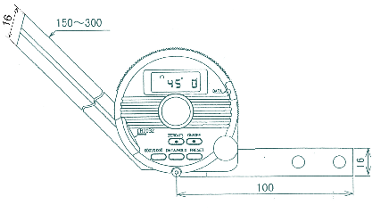

Order No.: Product Image: Model: Type of Blade: Display: Measuring Range: Resolution: Accuracy: Repeatability: Mass: IP Rating: Function: Max Response Speed: Battery: Battery Life: Alarm: Temperature Operation: Temperature Storage: Required Accessories: Optional Accessories:
187-552 BP-D300E 12" (187-103) LCD - 5 digit, (-) sign, character height 6.5mm -360˚ ~ +360˚ 1’ (0.01˚) ± 2’ (±0.03˚) 1’ (0.01˚) 1.45 lbs / 659g IPIP40 Zero, Direction select, Data output / Data hold, Preset, Switchable Seagesimal or Decimal Natation 3 rps Lithium battery (CR2032) 1 pc. (Part No. 05SAA217) 2,000 hours Battery voltage low, Over speed error (Err) 0 to 40˚C -10 to 60˚C -
